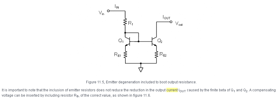

https://wiki.analog.com/university/courses/electronics/text/chapter-11
When building current mirrors with discreet components you should use emitter resistors to get good results.
Thanks for the redraw. I didnt realize that they were putting a resistor in the emitter of the first transistor too (Q1) somehow i missed that point.
I think it would be a good idea too as it would reduce the sensitivity to various variations.

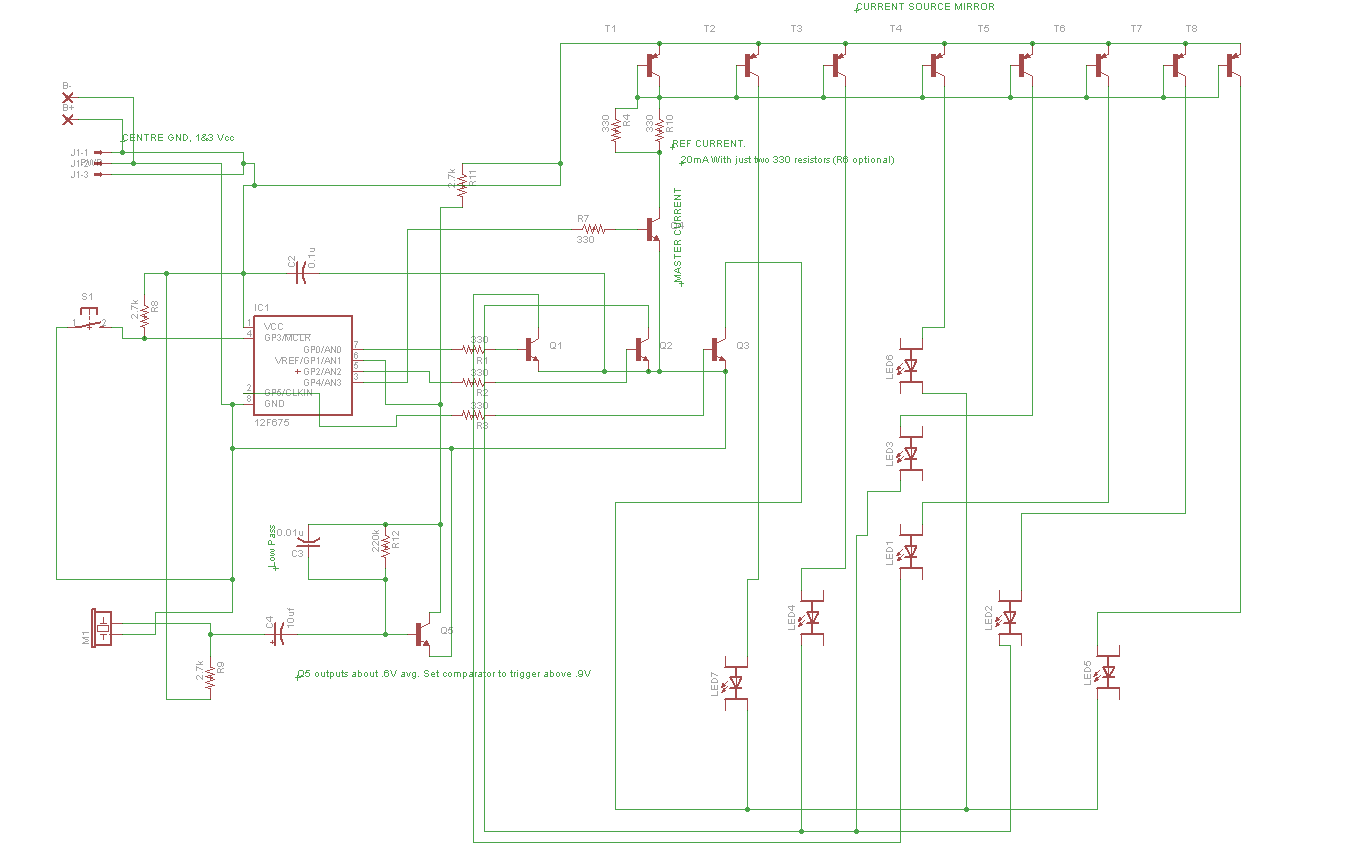

2) The CL520 by itself worked fine, from about 7-8 volts to 25 or more - the LED current remained at 20mA and the brightness of the LEDs didn't vary.
3) I didn't realize that the 20 mA gets split between all the transistors. Makes perfect sense. Duh.
4) I'm starting to come around to a bit of emitter resistance to even out the variations in Vbe of the transistors, but I did swap around the transistors and in any arrangement the non-CL520 LEDs were too bright, so I don't think the variation in transistors is the cause of all of these "issues".
It's worth a try: I will re-create this circuit with some emitter resistance and see if the LED currents are regulated - as in don't vary much with source voltage changes.
You could probably measure right across the CL520 during tests, to make sure it has at least 5 volts across it at all times. If it drops too low then it doesnt work anymore. They spec 4.75v, so 5v should make sure it works all the time.
I recently had need for a discrete set of 7 current mirrors (2n3904) to permit running LEDs at a decent current with a typical Vf close to the battery voltage. Dropping resistors would cause large swings in current due to Vcc being close to Vf as the battery discharged. Also Vf could vary quite a bit since I wasn't binning the LEDs based on Vf. I didn't use any emitter resistors and it worked fairly well!

Thanks Mosaic, I suppose that's a "mirror image" (no pun intended) of the same thing. I'm envious that yours seems to be working well, but mine didn't. It's all clear as mud to me now. I am wondering if your use of a limited range of DC voltage (I assume) allows it to work well. The schematic doesn't really show what the input voltage range is.
I did screen the transistors for a similar Vbe & Hfe. I discovered that a few of my salvaged trannies had specs all over the map. I ended up using all new ones from Jameco...standard bulk units but they were all within +/- 10 Hfe and 5 millivolts Vbe.

The circuit runs off a Li Ion battery...so around 3.6 thru 4.2V
Here it is in operation....don't laugh too much, its for kids. Play back is more in sync if watched on YouTube natively.
