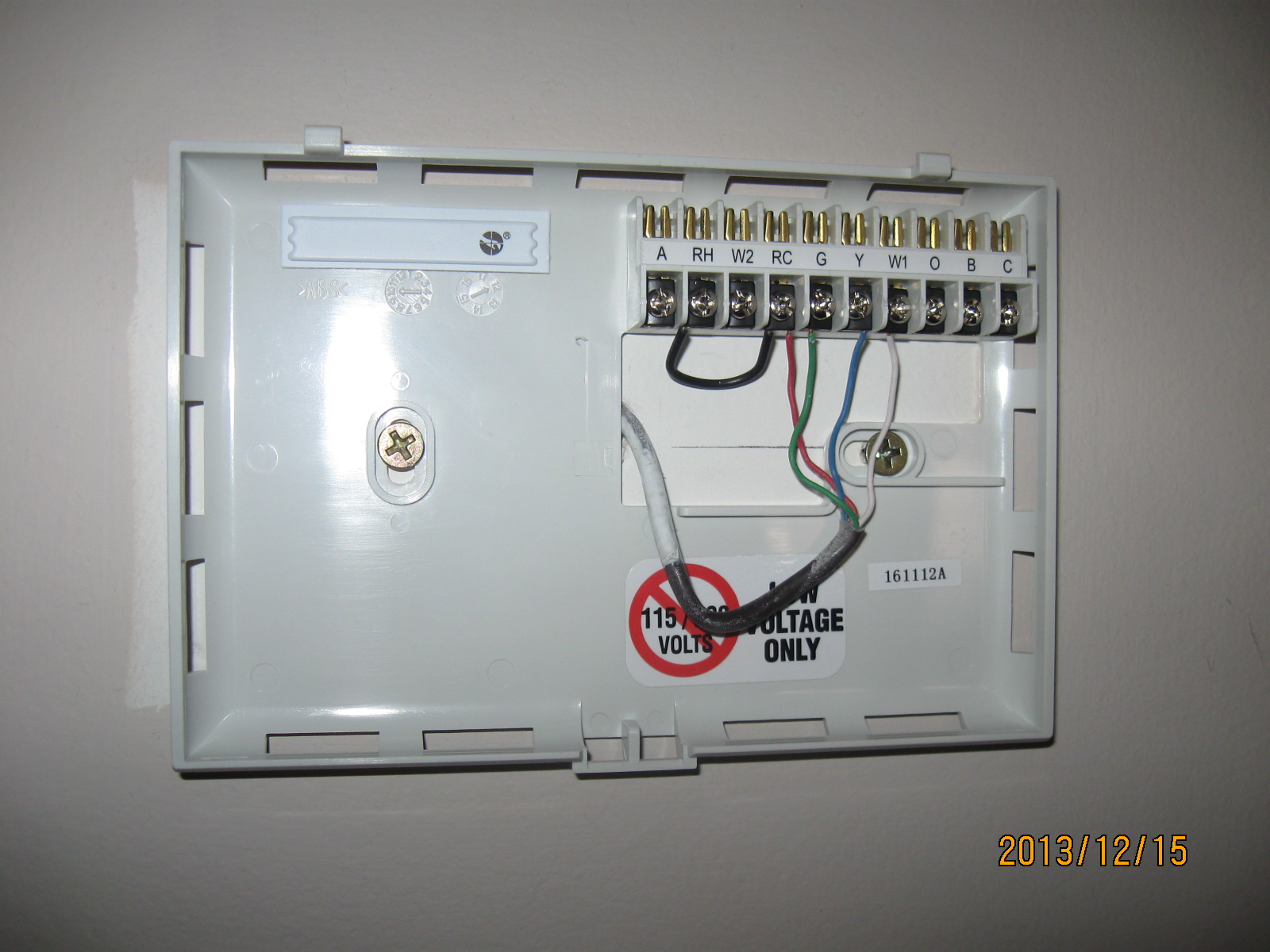

I need to replace relays on a Thermostat with Mosfet
I know is just control signal because on the board they are some diodes on each return wire and a cap
If they rectify it at the end anyway, you probably can get away with sending them a half-wave only. Just put a diode on the COM wire and then treat it as DC. This will save lots of board space, but it won't be universal and won't work on old furnaces.
With AC, you need to reference your battery supply to something, say COM. The biggest problem is that when COM goes positive, your mosfets will be negative relative to COM, and consequently negative relative to their gates. So, they will start turning on. You need to prevent this somehow and also protect your controller from this negative voltage. I don't see a good way to do that with diodes. Perhaps the capacitors in the original design will charge so slow that the mosfet will not have enough time to turn on during this half of the cycle. In this case you just don't do anything extra and it simply works. However, with almost no load, mosfet will turn on very easily. You need to experiment with this.
Make it simple, i need the features on mine, without relays : contact 120 vac / 2 amps
The fan probably needs more than 2A, especially when starting. It would be tough to switch even if you had an access to the second AC line, yet alone under $6.
are you trying to make something that will be sold or just something for yourself, here's another try which is different form the others. not sure what will happen with more than one fet on at a time, could get a cross connect problem.

The OP is building a thermostat or should we say multiple thermostats in a zoned system and wants something small and cheap.
So, let's revisit the original problem:
A small and cheap replacement for a 24 VAC relay for use in a typical heating/cooling thermostat where the intention is building a thermostat from scratch.
I'd look at the OPTOMOS series of relays: https://www.digikey.com/product-search/en/relays/solid-state-relays/1048664?k=optomos
Now, they could be a little power hungry, but some require currents on the order of a mA to switch, so one might not be able to pass the power budget.
Call 4 batteries, $5.00 and the device to add a wire $25.00. Payback is 5 years. Without batteries (OK, maybe a lithium or supercap), the unit is smaller, but you won't have heat if you don't have an extra set of batteries. More savings could result if you could run the extra wire in some places.
Another idea would be to build everything inside the furnace. My Lennox has plenty of space, others should too. Then you can use thermostat wiring simply for communications. It'll be cheap and won't take space on the thermostat's PCB.

I see. This changes things. You must be wire-for-wire compatible with regular thermostats, and you cannot even do trick things like using electrical ground.
I would go with optoisolators, what KISS suggested or similar. It'll be less space and money that the original circuit.
I do think that the original circuit should work if capacitors are large enough. It is definitely cute. What I don't like is that large capacitors will also lead to long[ish] transition periods.
You are perfectly right
The KISS suggestion is great , but i cannot use it on this project
1. even at 0.11ma it is still a constant consumption
2.at 4.4 dollars per piece is 0.9$ higher than one coil latching from TE Connectivity
