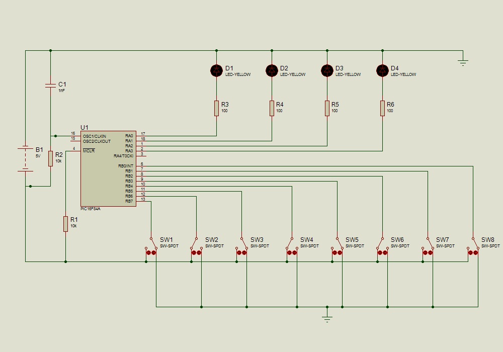

Hi guys ......
I am still learning my self "how pic Microcontrollers works ??!!!" , i tried some simple projects in ISIS to apply what i have just learned ..... but the result was not good .... i tried to apply the 4-bit binary adder with pic 16f84a and it doesn't work ...... it seems to be that i am sure about my assembly code and the schematic connections ..... i uploaded my simple project for u to check it if you don't mind helping me .
with my all best wishes friends and i am waiting for your feedbacks.

Hi
Try this bit of code - I've corrected some points highlighted - so it builds ok.
Have not run your Main code to check the logic of all your addition routine - will leave you to do that.
Have fun..

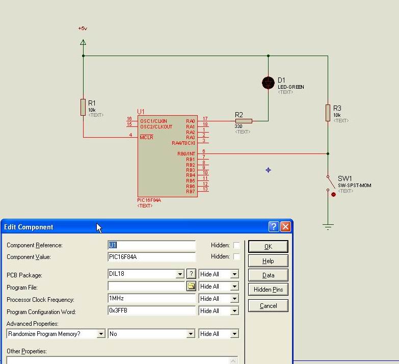

Opps, missed your Isis Diagram - that will not work ! - will post a new diagram in a few mins
Here is a diagram for your Simulation, just one led and switch shown.
Note that you do not need to show the battery or the oscillator.
If you Right click on the 84A it opens the window shown.
In there you can specify what osc frequency you want.
In the line above , Program File you can Browse and point it to your .hex file.
You will need to check the Logic state of the switches against your program code, when they are Open the resistors pulls them up to 1, when the switch is closed it becomes 0.
