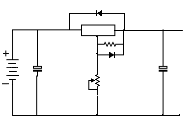

I need an adjustable power supply
I will almost certainly add meters to the polished article but I don't have much faith this current project will be it (just the way I tend to work when it comes "prototypes").
What I'd really appreciate some advice with (apart from the component choices) is terminals. So many devices have so many different types of connectors it's always a party-trick trying to cleanly attach a positive and negative to something while operating the supply etc.
Getting back to the capacitors and my lack of understanding their usage. I know they are rated by their capacity to store energy and the voltage they can pass and I know there's a formula to calculate the value required but is their a general rule of thumb the layman can easily understand?
Also, do I need to fit a heatsink to the voltage regulators?
EDIT: I think I've drawn the circuit made. Sorry it's so poor and incomplete, I can't find any programs that I can fathom how to use or allow for simple file exporting in a common format.
So the next step is to make this a dual regulated supply. ie, one supplying ~12v while another ~4v but they share the same circuit IYKWIM. I'm thinking of replicating the single supply and inserting it in parallel to the source or after the source's capacitor?

Good grief! Seems like I can't even join-the-dots anymore without fouling things up! What have I done wrong, it worked on the breadboard? :confused:
First attempt I'd connected the source power to the wrong connection and could smell something getting too hot. Correcting the wiring, testing then gave 28v through the complete pot adjustment except at the very end when it dropped to ~1.3v
Assuming I'd damaged a component, I made a second board with new components only to have the same outptut reading - 27v until the very last adjustment where it drops to ~1.3v
This is how I built the circuit;-
I have one diode cathode to LM output and anode to LM input.
Other diode cathode to LM adjust and anode to LM output.
A pair of 240Ω resistors in parallel between LM adjust and LM output (same as diode above).
The pot has outer and centre leg soldered to source negative and other outer leg to the LM adjust (before diode and resistor).
The only component I haven't added is the output capacitor which I'm assuming wouldn't cause this problem anyway.
There are no short's I'm certain but whatever the mistake is, I seem to have made it twice. Can only tell what it is? I'm totally baffled.
Are you completely certain you have the diodes facing the correct way? You seem to have your anode/cathode mixed up in the above (the diagram is correct). Current flows from the anode to the cathode. The cathode is usually indicated by a stripe on the device.
There should be one with the cathode (stripe) on the regulator input and anode on output, as well as one with cathode on output and anode on adjust.

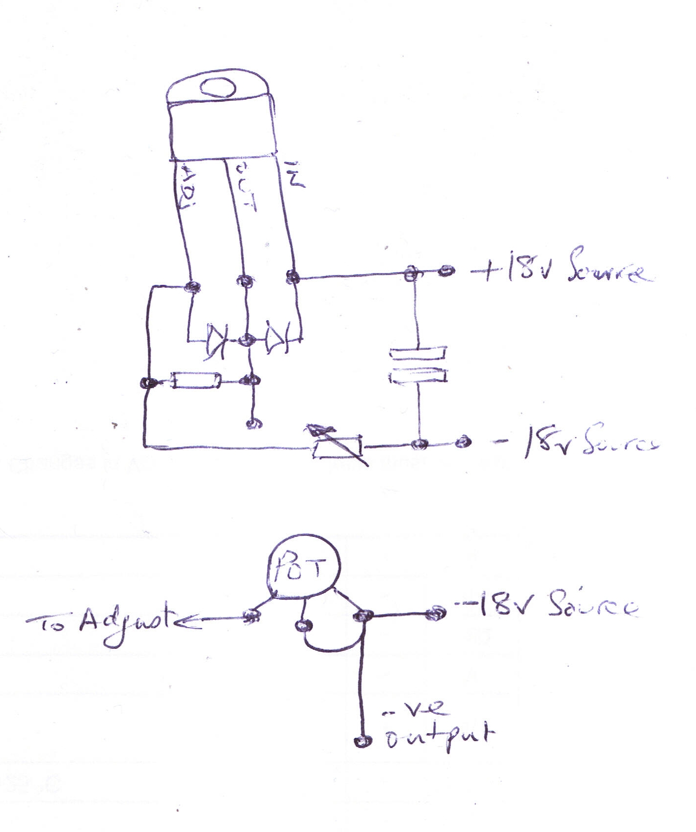

I've sat down and tried to draw my circuit but while double-checking the LM pinouts I'm reminded that I never was 100% sure of the orientation shown in the datasheet - I just assumed from the results I'd got it right. So can someone please confirm what the datasheet refers to as the "top view". If you differentiate the printed side from the heatsink side, I'll know for sure.
In the meantime, I'll see if I can get my hand-drawn circuit 100% accurate and scanned in.
Attached is my poor effort at drawing the circuit. In the UK, we use the rectangle to represent a resistor. In my case, I had to parallel a pair of 231Ω giving a total reading of 116Ω
I have yet to add the output and adjust capacitors, hence they're not shown. I've also included how I've wired the pot just to be sure I've not introduced a mistake there.
If I've got it right, the diode stripe is on the right side.
Capacitor = 100µf 25v
Resistor = 116Ω
Diode = IN4001
Pot = 5KΩ
I hope that's clear and thank you for taking the time to assist me.

Your picture is rough but all the wiring looks good.
I checked the LM317 datasheet and you got the pins right and all the parts are in the right place. The only things I can fault is that you need an output cap from Vout to ground and a cap from adj pin to ground (or across the pot).
But other than that it looks ok.
How are you measuring the voltages? And have you tried attaching a load to it (like a resistor ar a light bulb etc)?
Please don't assume I've got the LM pinouts correct as I couldn't tell from the datasheet which side is facing out - the printed side or the heatsink side? In my drawing, you would be seeing the print. Is that correct?

That sounds like you have it wired wrong,it looks like the fan is being supplied through the resistor, not the LM317.

Well that datasheet confirms I do have the LM orientation correct and the pinouts right so the problem must be in my construction layout. I'll have to go back to the breadboard (where I didn't have these problems) and get the complete circuit working before moving onto a soldered board. Thanks for supporting me through my errors Mr RB (and other contributors), I do appreciate it very much.
My problem might be compounded by a faulty pot - it seems to give almost infinite resistance intermittently, particularly frequent when moved/used and it's the only 5K pot in the "lucky bag" of pots I bought.
I'm completely stumped now as I'm still getting a variable 0.3 to 1.0v between Adjust and Output and I've only added the pot and resistor. The output works as expected, driving the fan as a load while showing 1.0 to 15v on full Pot adjustment range.
Is it my sequence (see below)? i.e. The position of the joins? My logic says not but what do I know.
I inserted the LM into a veroboard, bent the Adjust leg (Pin1) back and soldered the resistor to it's very end. Bent the Output leg (Pin2) forward and soldered the other side of the resistor to the very end of the leg. Then soldered Pot to Adjust leg and +ve source to Input leg(Pin3) with the other Pot terminal to the -ve source. There are no further components at this stage.
And you are still using the 120 ohm resistor and 5k pot? If so it should be working.
If you don't mind, can you do something to test it;
Adjust the pot so the output is 10v (10v from Vout to ground). Then measure voltage from Vin to ground, and from Vout to Vadj.
Then connect the 12v fan between Vout and ground (don't change the pot adjustment or anything else) and measure all those voltages again.
