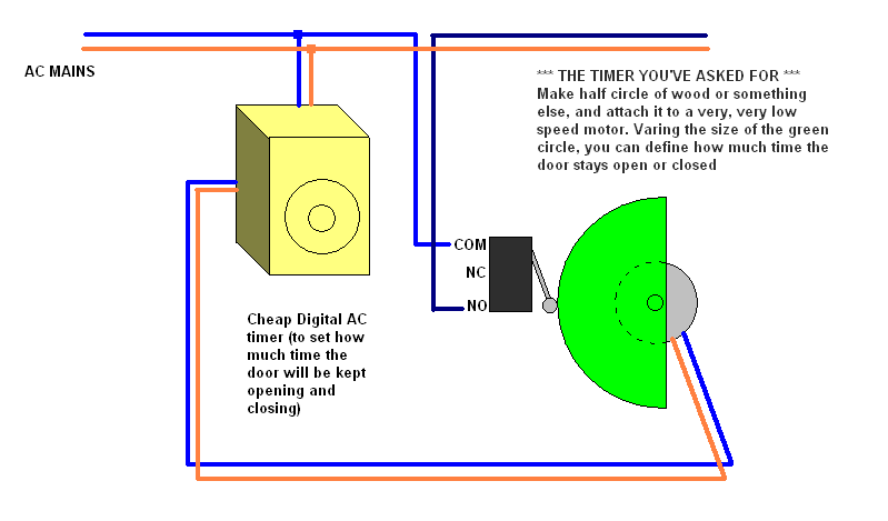

Ok, you've said that you have no electronics knowedge, so the learning curve doesn't justify for the project.
Instead, I suggest you to make an electro-mechanical timer, I've made a small drawing for you.
The "green" timer is the 1-15 min setting thing, the other (beige box) is because you want to repeat the same operation at a defined time
forget to write, the black thing is a microswitch, available on any store

It is always good to have another's perspective. I get it.
Thanks for the suggestion.
In that case the electronics is the way to go. Is a stupid question: have you any friend or somebody with electronics knowedge? I mean, to avoid exposing you to dangerous voltages/currents, he/she can take the schematic to real world
