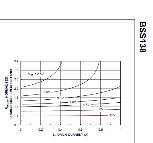

Then the 'Rds' also depends to gate voltage? Eg. if Vgs/Vth is 3V then Rds= 0.3R, if we applied 2.5Vgs then the Rds= around 0.5R and if we applied 1.5Vgs then the Rds= around 1 or 2 ohms, like this? (And the increment of Rds makes output voltage drop too.)
hi Willen,
Its the Rds resistance [resistance between Drain and Source] that as to be considered with MOSFETs.
Look at this image of Rds, you can see if the Vgs [ voltage Gate to Source] is 'low' the Rds is high, so you will have a bigger voltage drop across the Rds and more heat being generated in the FET body.
Driving the Vgs higher will reduce the effective Rds and so improve the overall efficiency of the FET.
ie: lower voltage drop across Rds and less heating.

I'm going to be switching on a 2.5v amp and cell circuit... I have to maintain some degree of accuracy..
Current isn't really the issue.. A loadcell with a 1k bridge will take 2.5mA and the amp about .5mA.. but the transmission circuit will need 12mA ~ 20mA whilst transmitting... Luckily the radio has an OFF pin so I wont need to worry on that score..
So how to keep a ratiometric voltage level on my amp circiut... I could use an ADC pin and read the amp voltage so I could read the loadcell amp at the same level ( dynamically so to speak ) but the proximity switches are power hungry little devices... I have made my own pickups so the mA is as low as I dare go, but at 3v the signal isn't very high so I darn't go any lower.... Switching with a bipolar will use 0.6v so its very tight... I was hoping the mosfet would give me nearly 3.7v.. but the RDon has to be non exsistant.... When I use the mosfets in my motor driver, I get virtually 0 RDon as I have mosfet drivers.... I'm going to buy several of these ( suggested by you all Thanks) and do some experimenting....
So you need to buy a FET with a very low Rds at a Vgs of 3.5V (they exist) , or you need a charge pump to drive the gate of a less-capable FET.
Is the FET switch high-side, or low-side?
For lowest RDS(on). N-channel, low-side is till the best. If you need high side, your choice will be a P-channel, a high-side driver, or an integrated device as I mentioned above (post#8).
