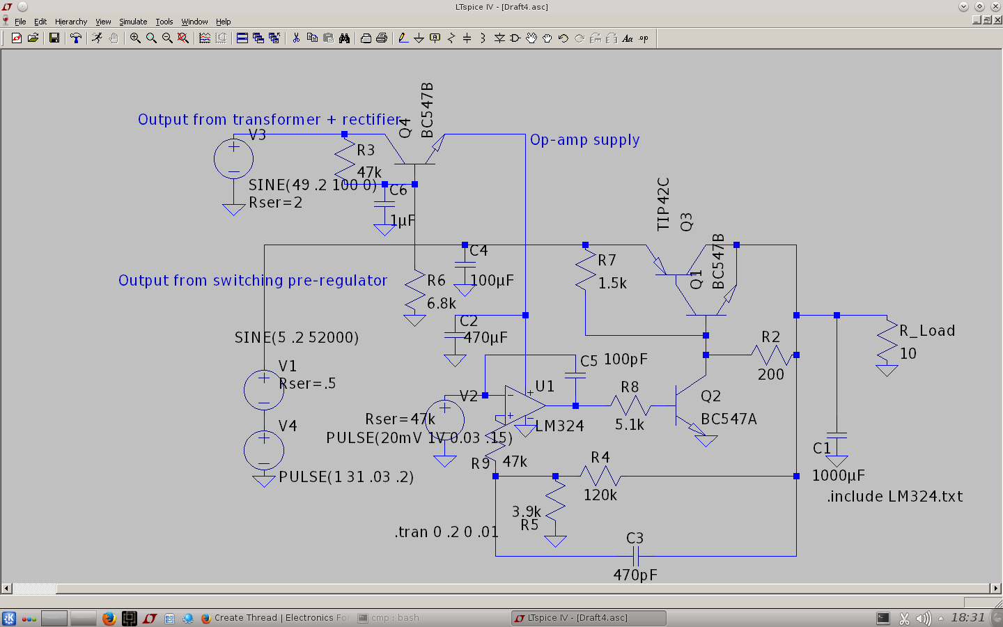

I arrived at this design for my PSU's linear output stage and tweaked it in LTSpice until I got a nice linear rise in output as the control voltage is changed.
So what we're looking at is a mains transformer/rectifier/smoothing producing 49V, a switching stage (represented by V1 and V4) which tracks the output and produces around 5-35V, and this linear stage, which will eventually have an adjustable current limit. I didn't think it necessary to regulate the low voltage supply for the op-amp.The output is adjustable from 0 to around 30v
V2 represents a 1.2V reference (ICL8069DCZR because they were cheap on eBay) with a 47K multi-turn pot across it (again, cheap on eBay),
I chose TIP42 as the pass element again because of cost, and LM324 I already have. BC547's I have a lot of old ones, that's why I'm using those.
I think that Q2 and Q1 should be thermally coupled, but I'm not sure.
I found that putting in R2 makes the output more linear, but I don't understand why. Make it low enough and it stops a nasty kink appearing in the op-amp's output at about mid-range. So can anyone explain what is going on there?
Also, I arrived at values for C3 and C5 by trial and error. I'd like to know how to calculate what they should be - so can anyone help me with that?

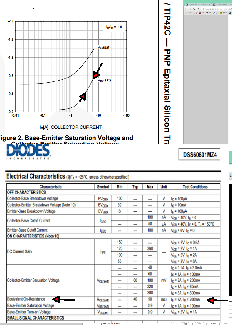

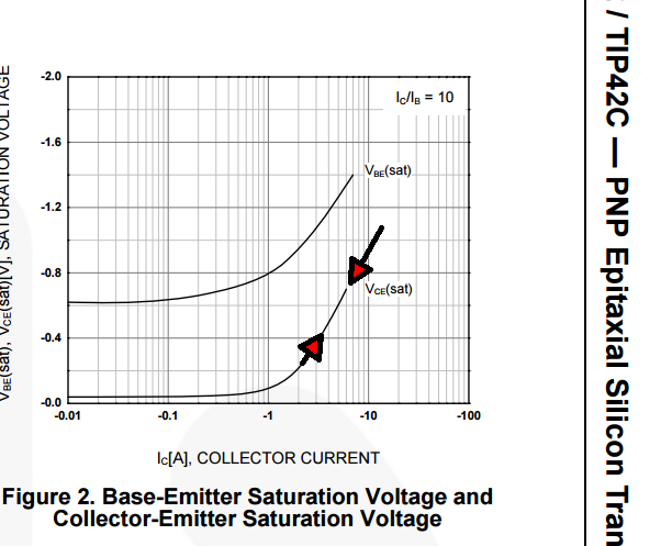

TIP42 is around 0.11 ῼ in the 3~6A region
MOSFETs can get much lower easily. Sure you want about this Linear approach?
Also current sensing can be done with 50mV shunt R for protection.
Strange way of putting it?, you don't get a 'resistance' with a bipolar transistor you get a 'voltage drop' - but even then both of these refer to switches, not to linear operation of the devices - if your linear PSU regulator is switched hard ON, then it's not regulating at all, and you're far exceeding the capability of the design (and outputting the full unregulated supply from the reservoir capacitor).
Actually all semi's used as switches and diodes including LED's have a fairly constant ESR {rbe, RdsOn, rBE Rce } when saturated.
Only Diodes Inc.(nee Zetex ) are clever enough to actually include this in all their specs.
BJT's used as switches have a Rce spec.
I obtained it from the VI slope in this region.

Cooo-eeee *waves* Guys :) Very interesting but not answering my questions! Don't like to appear rude but,
Why does R2 make the regulator more linear?
C3 and C5 have a big impact on ripple, trial and error is all very well, but I'd like to know how to calculate what they should be!
Thanks :D
Your output driver is basically unipolar ( Pullup or source only) which is rather suboptimal compared to bipolar drive. such as complementary emitter follower or complementary MOSFET ( aka cmos)
Adding R2 does 2 things. raises output impedance for sourcing ( by lowering the self-bias current point and lowers sinking impedance from open circuit to 200 Ohms. (Still high compared to 10R load)
The closed loop gain R4/R5=30 also reduces the output impedance by a factor of 30 but only for small signal response.. thus it can track small changes as long as 200R can feed Ic=Cdv/dt on output load.

Even a bunch of CMOS buffers (ALCV2 type) each with 25 Ohm source impedance bridged in parallel with Rf/Rin feedback would make a better linear pulse driver for driving 1000uF
Loop stability requires Bode Plot and knowing gain and BW of each stage to calculate C for accuracy and stability, which is one way to a buffered Op Amp design.
The LM324 quad and its sister the LM358 dual are poor for linear circuits because they produce crossover distortion and are very slow. The distortion causes a kink in a linear ramp. The distortion and slow speed are because the opamps are low power and do not have enough bias current to be linear and fast. Look at what it does to this sinewave:

I'm basically doing a low-budget version of this:
https://electronicdesign.com/boards/simple-switchers-make-simple-pre-regulators
https://electronicdesign.com/site-f...ctronicdesign.com/files/29/6388/figure_01.gif
But this is just the linear portion.
I swapped the op-amp in the original for an op-amp + transistor because of the high supply voltage I have (49V), which means I can use a low voltage OA. Also the original is really expensive.
So the kink in the output if R2 is a higher value (like 1k) is caused by crossover distortion? Fascinating. So I would be better off putting a long tailed pair in there instead of the OA?
Tony, searching on the hoofernet for ALCV2 only produces threads where you've (I'm guessing you are SunnySkyGuy!) suggested it, no data. Can you enlighten please?
Thanks for the useful tip for obtaining ESR of semi's btw, one of those things I want to know on rare occasions.
Apart from the switching pre-regulator this is a general purpose bench psu much like any other. I just want to get the ripple as low as I can and make it as regulated as I can, as cheaply as I can :D

Yes your R added gave the minimum passive pull-down needed to drive a large cap with linearity and negative feedback .
Thanks for the responses Tony, AG & Nigel, now I have something I can get my head around :)
