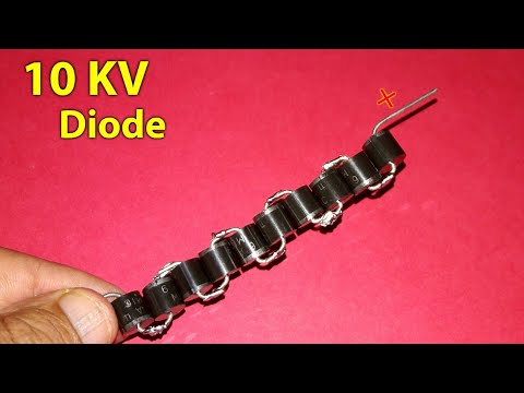

The simplest and cheapest is an appropriately long string of series 1N4007 or (UR4007 / UF4007 for high frequencies).
Add a high value resistor that's rated for at least 1000V and appropriate power across each diode, to balance out the voltage, so no single diode gets overvolts and breaks down.
(eg. 1M Ohm, 1W).
It's a common construction technique for both DIY and commercial rectifiers - though some omit the equalising resistors, which to me is asking for trouble..
