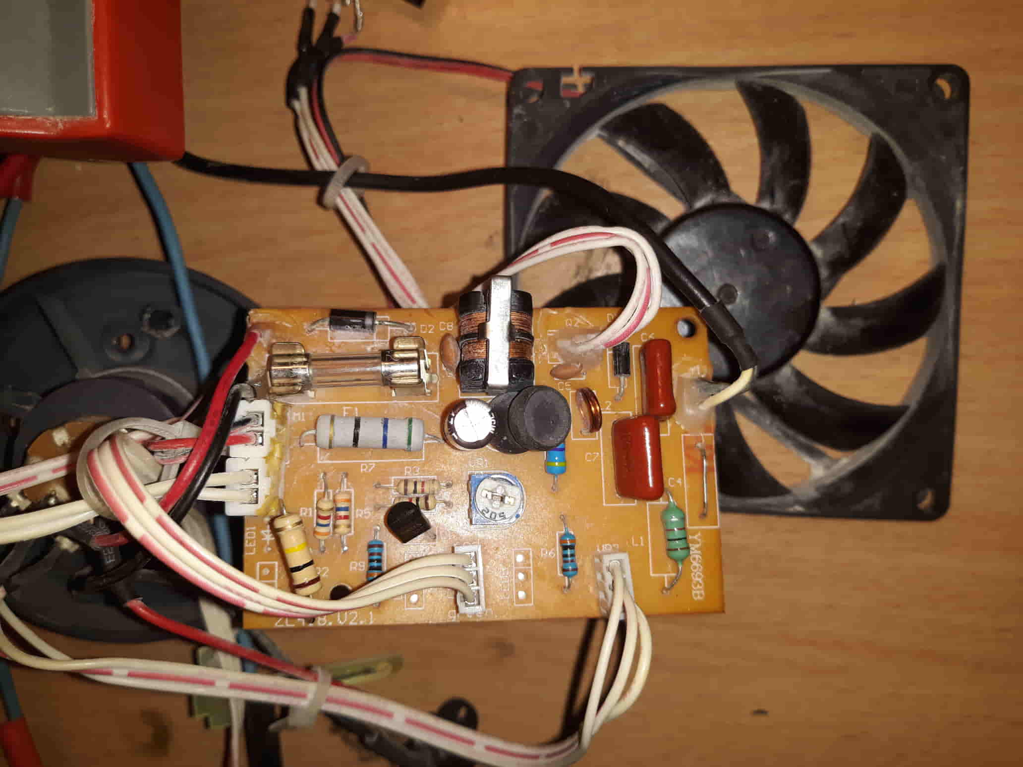

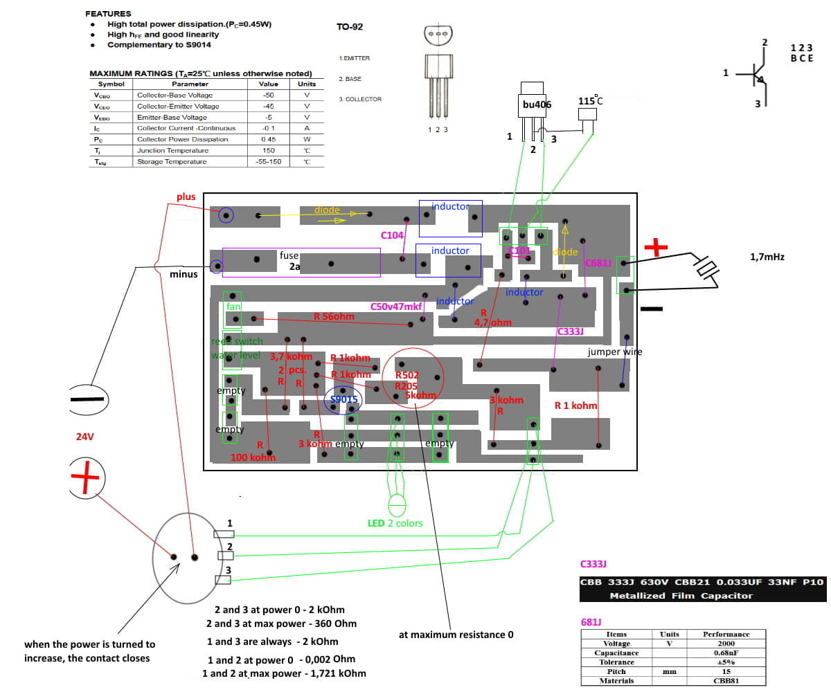

Hello everyone.
I'm interested to know in which software emulator I can repeat this scheme?
thanks.
Spice simulators like PSPICE, LTC Spice, Simetrix, TINA......
You need to know the magnetic properties that were used....as well as all the other components.
Same for the ultra sonic transducer.....
