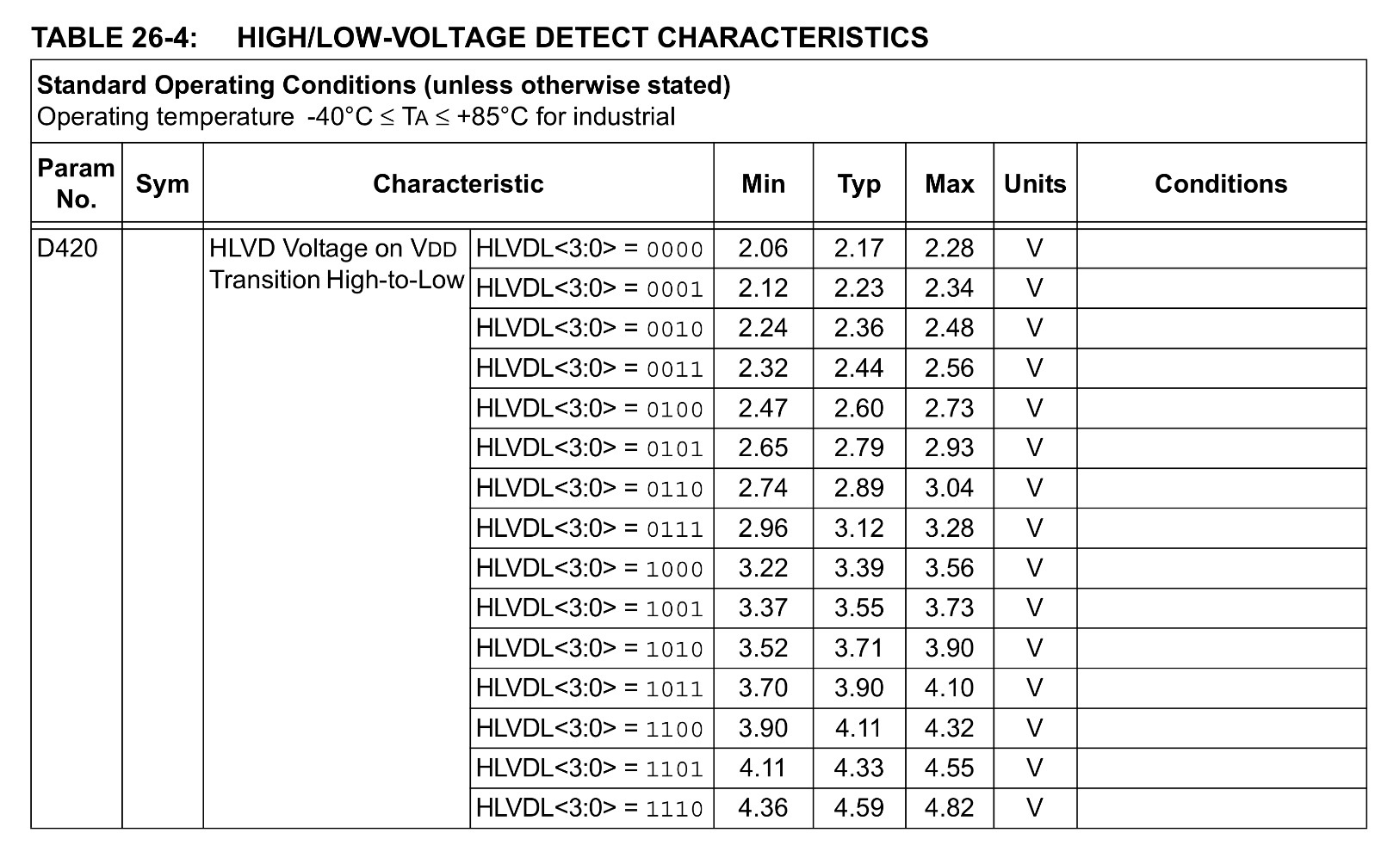

image.jpgWow. MrDEB may have stumbled across something that will work.
The unanswered question in MrDEB's post is of course the range of the High/Low Voltage Detect circuitry and therefore the need for a voltage divider. A little research in the data sheet found this table for a standard 18F-series part.
For this 5 volt part, there are 16 increments of about 0.2 volt spacing, but note the tolerances on the measurement. For example, setting 0111 can vary from 2.96 v to 3.28 v depending on chip tolerances. With the flat discharge characteristics of alkaline batteries, selecting the correct range may have to be done for each part.
I am not real concerned about accuracy, just want to indicate when the battery may need to be recharged with plenty of leeway.
The transmitter requires 2.4v so I was going for 3v to trigger the HLVD.
If I go with Vdd/10k/HLVD input/ 50K'grd to start. then set the HLVD for 2.44 or 2.60.
This should maybe cross our fingers give enough leeway. Perhaps a trim resistor but that's going overboard IMO
If not then perhaps just use the ADC but Microchip put the HLVD on the chip for a reason. I looked on the microchip site about this hoping to be able to connect directly to Vdd or other info but zero!

Geez oh grief. I hand this to you on a silver platter and you still don't get it... Between the table (the key piece you didn't even think to look for) and the schematic of the internal arrangement in the section you quoted from, you have EVERYTHING needed to UNDERSTAND how to make it work.
If you are going to make a reliable battery test, "I'm not really concerned with accuracy" is just not going to cut it.
It's somebody else's turn. Anybody?
I understand how it works but maybe and how to implement but I misunderstood something?
My goal is to have a simple LED indicator of battery condition. Accuracy in this application is OK but not a prime goal. When the user is done for the day of bike riding, if the battery is close to 3v then the LED begins to blink. I have a voltage divider made up of two 15K resistors connected to RA5. Just need to program the HLVDCON and see what the results are. but at the same time wondering if just using the ADC of say RA0 then using a FUNCTION statement would it be basically the same thing. BUT as stated, Microchip put this HLVD on the chip for a reason so might as well use it to make life simpler. One big advantage of using the HLVD is it probably uses a better implemented voltage reference than the ADC and or lower current draw.
DUH hit me on the head with a stick!!
while setting up the HLVD I see I don't need to connect the external voltage divider. Just program the desired bits unless an external voltage source is desired. So I want
hlvdcon = 00110110 which equates to 2.74 - 3.04 volts.

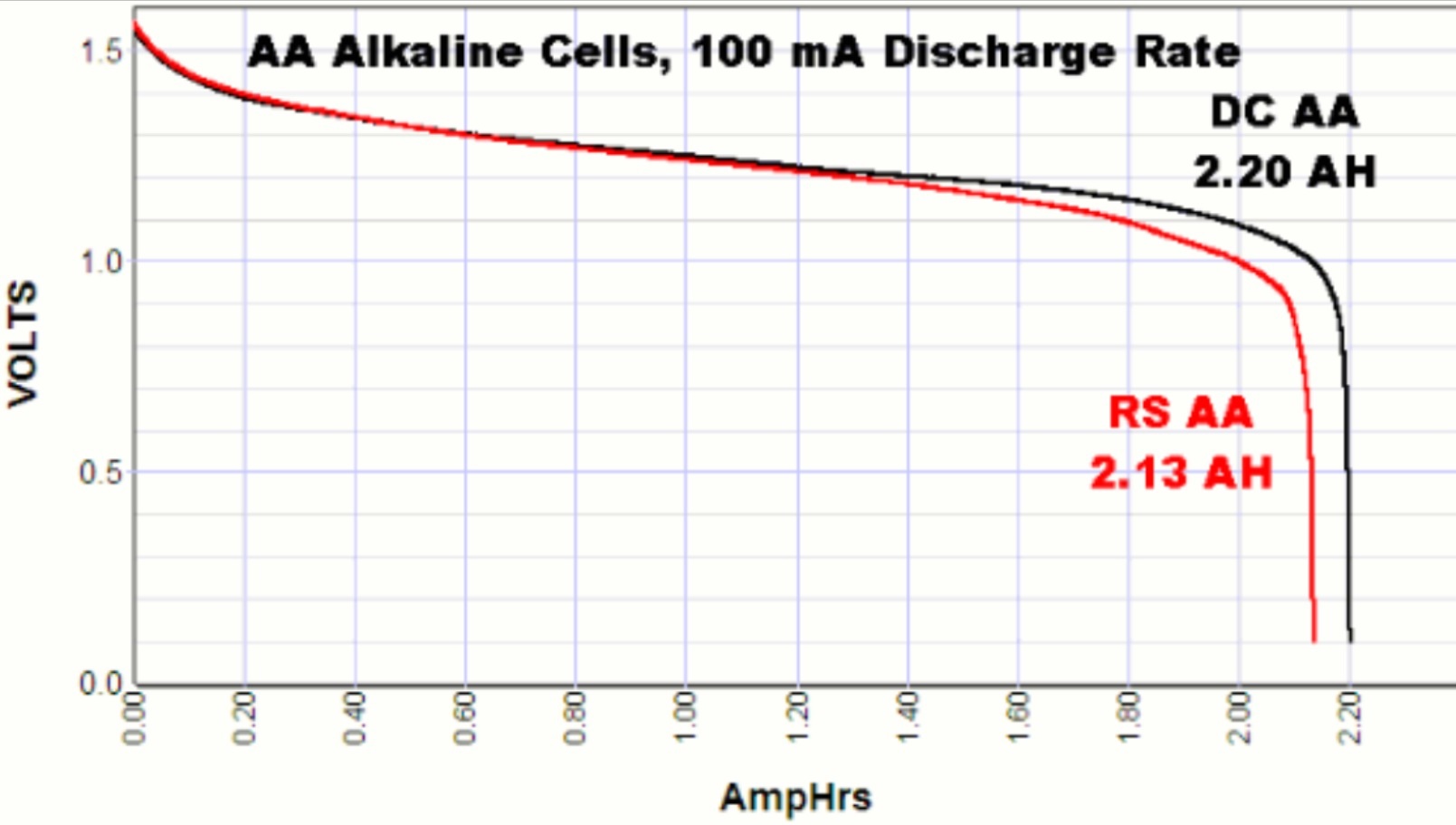

*shrug*
You are missing several points but that's not my concern.
Do you even know what the discharge curve for whatever-the-heck batteries you're planning on using looks like? Most are very flat until the battery is nearly dead, and then they drop like a rock. At 3 volts for a 3 alkaline cell pack, you'll have only minutes of warning before the batteries are dead.
"When the user..."??? If you are planning on selling this claptrap to the innocent public, you have to pay attention to the details. Somebody is going to get killed.
YES I need to decide on battery type so battery discharge curve is not known. My mistake 1
unit draws a max of 15ma intermittently but .04 during sleep so I need to calculate how long will batteries last between 2.5 volts and 3 volts at a 15ma discharge rate.
Battery pack, depending on battery chemistry is 4.5v (3-AA alkaline) or less as most rechargeable are 1.2v. Am avoiding Lithium Ion for exploding issues.
I realize I need more details.
