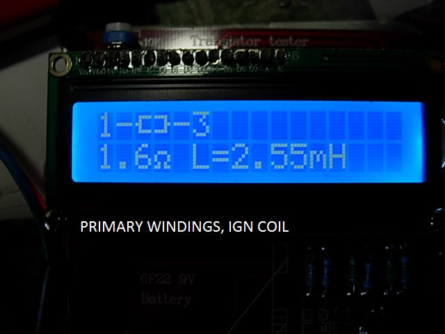

Looking for a simple choice of a coil with a largest number of turns, an automotive ignition coil comes to mind.
Am after the largest number of (secondary) turns and a straight bar type core, not 'E' core. How to select/pick such ? Measure secondary inductance ?
Can you suggest any other off-the-shelf items that could be a source of 'zillion' turns coil ? No significant current needed.

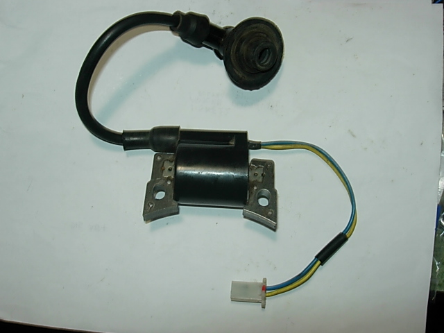

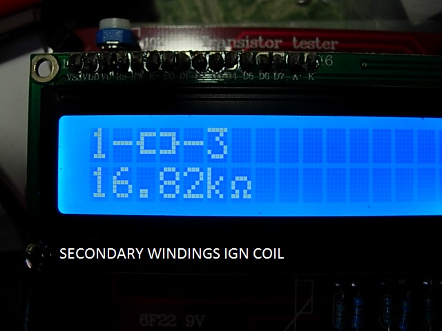

theres heaps of these types of ign coils on Ebay. This one is off a Kipor inverter generator & powered by a separate ignition module. My tester wouldn't read the secondary as inductance only resistance.

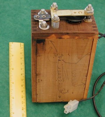

I have a buzz/vibrator coil that I use to start a small pulse jet. They give a pretty good spark, but some of the prices on eBay seem outrageous. Mine appears newer than early 20th century, maybe NOS, or maybe new replica. It was purchased this century and cost about $12.
Here's what they look like:
John
Model T Ford coil. Or that's what they used. They had four of them each feeding the 'distributor'.
