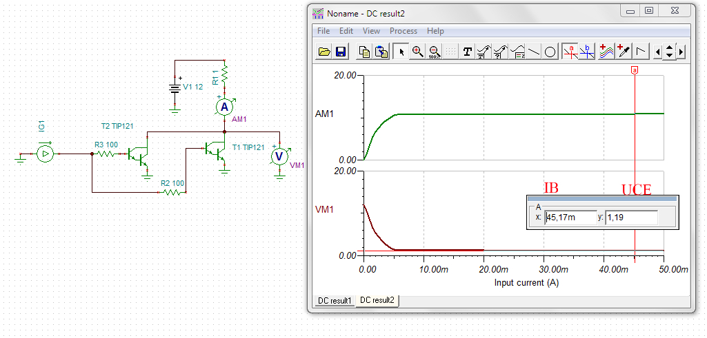

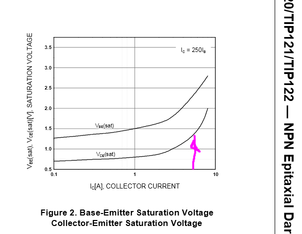

121.jpg tip121sat.jpg TIP121 VCE Sat. characteristics:
can i also use, 2 TIP121, to do the same job?? u know, like wired parallel..
TIP121's are darlingtons, they can't be saturated anywhere near as well as the TIP35 - essential what we're discussing here with the TIP35 is a 'super' darlington, which overcomes the limitations of a standard darlington (but is configured differently).
Yes, you're right. It's a typical characteristics at 25 Celsius.
You cannot buy a "typical" transistor. They might not have any and you might get a "minimum" one.
EDIT: The graphs in a datasheet are for a "typical" one.

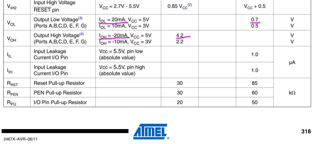

1)the controller i am using (Arduino atmega128) does not produce High enough pulses, to compeltly saturate the Mosfet, resulting in ,it, working with some on-resistance

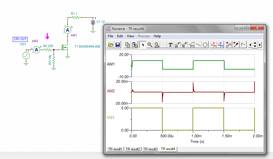

Hello,
The IRL1404 is not a "logic level" FET.
The threshold may not be low enough to saturate it with 5V.
Try something like the BUK954R4-40B for this application.
Regards,
Csaba
