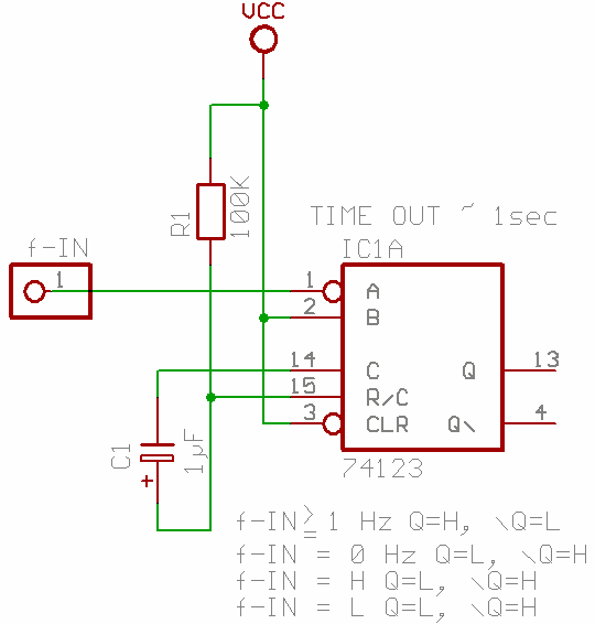

I want to use square wave(varying duty cycle) as input signal to switch ON a device.
When the stream of pulses stops, the circuit should give an output(high).But not(low) if the input is constantly high or low.
In other words i want to detect rising and falling edges.
prash.
And when the stream of pulses stop, what status the input remains in ?
And what time after pulses stop you want the circuit to give an output high ?
in put will be constantly high or low when pulse train stop.output should go high immediately when pulses stop.
missing pulse detector is nearly OK but it does not serve when pulses stop and input remains constantly at high status.
I have the strong impression that you expect others to do the thinking for you.
You even haven't posted the frequency you want to monitor.
A 74L123 is a monoflop which can be used as missing pulse detector. This chip has two outputs which you can use for your convienience.
The attached circuit monitors any frequency starting at 1Hz. It times out approximately 1 second after the last pulse received and changes output states accordingly.
The "truth table" is contained in the schematic.
If you want the circuit to switch immediately please do the math on your own.
Boncuk

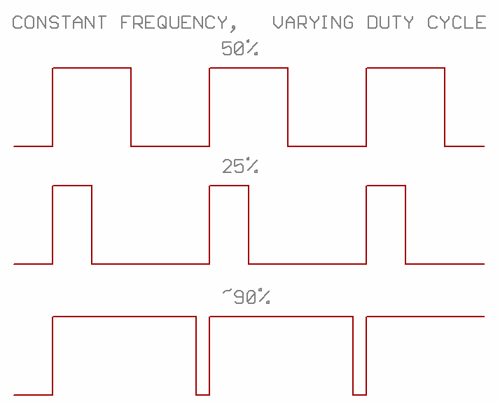

I regret if i put such an impression.In fact i know not much in digital (analogue is my field).I had mentioned "varying duty cycle"which i mean is varying frequency(??).
Any way, it seems you suggested the right thing.let me try it for my purpose and come back to you to thank again.
prash.
prash.
No, prash,
varying duty cycle doesn't mean varying freqency. The oscillator's clock cycle doesn't change with varying duty cycle, hence the pulse rise time is always the same which is important for the missing pulse detector's proper function, since its timing circuit is triggered by the positive going pulse edge.

thanks Boncuk for correcting me.now i realize varying duty cycle does not mean varying freq.
