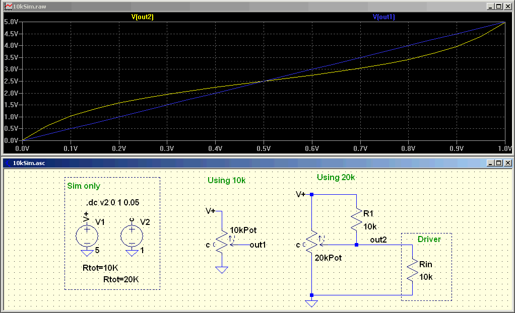

I have a driver that get a voltage input between 0-5VDC that is reocmmened to be across a 10K trimmer. I am using a digital pot which only strats from 20K and up. How can I use this 20K to interface with the above voltage input.

I would think the 20k pot would work okay, but perhaps with some non-linearity in the output voltage versus pot position. How critical is pot position (setting) versus voltage in this application?
Do you know what the input impedance of the driver is?
If you can put up with a non-linear output-voltage versus input-number response then the simplest way would be to use two 10k resistors with the 20k pot. One R goes from the 'wiper' to one end terminal; the other R goes from the 'wiper' to the other end terminal.

The input impedance of the driver is 10K. Since I had the only option of 20K digital pot in my design, I ended up inputting 10VDC across the pot to get 5VDC at about 3/4 poistion when connected to the driver which works for now but not ideal. I would like to use 5VDC across the pot too, this way users wont go above 5VDC which is not recommened for the driver.
So, that would be similar to Fig 9 in the article above. Does this give 10VDC full scale if I have 10VDC across the pot when connected to the driver?
Here's a simulation comparing the outputs from a simple 10k pot and a 20k pot + resistors combination, assuming Rin (the driver input impedance) is 10k.
Edit: Note the supply voltage V+ is 5V here, NOT 10V.
