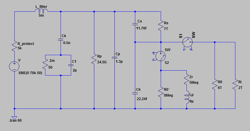

Hi guys,
I would like to make a simulation of a electric discharge programme with Ltspice. The circuit looks like below:
At the beginning, switch 1 will be closed and the switch 2 will be opened until the voltage of capacitance Ch Uch is higher than 15kV , then we close switch 2 and open switch 1. When Uch less then 12kV will switch 1 closed and swich 2 openesd again.
Anyone know how to connect these two switches into the circuit with the tunnels + and -, and how to write the SÖPICE directive for these two switches.
Thanks a lot in advance.

Here's your asc file with the switch model statements.
Btw, where are you going to buy a 24.5G resistor, a 22.4femtofarad capacitor or a 6teraOhm resistor :confused:

Thanks a lot!!That is really helpful.v
One more question. Because the switches also work when the voltage is -12kV or -15kV, so, can i add another value for Vt and Vh of two switches?
like: .model ms1 sw(Roff=1 Ron=1e12 Vt=13.5k Vh=1.5k Vt=-13.5k Vh=-1.5K)
That won't work (try it and see; that's the beauty of simulations :) ).
You could add two more switches: one in parallel with S1 and the other in parallel with S2. Then use model statements ms3, ms4 incorporating those negative values for vt (but +ve values for vh, otherwise the switch operates more like a potentiometer).
Done! Yes, i have tried and solved the problem already.
Thanks a lot
