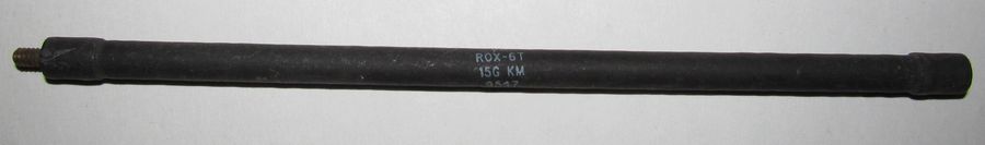

Could you use a resister divider something like this?
That will Never Work on a Car Coil.
Not with those LOW VALUE Resistors.
Due to such LOW Current Available, The Car coil output will get pulled Down to just a Few Volts.
You Need a Divider with High Voltage Types of Resistors and With Values up in the GIG Ohms.
I do this Quite Often and I have Gig-Ohm and also some Tera-Ohm, HV Resistors.
The Resistor in the Picture above is 15 Gig-Ohm, rated at 37 KV and its 6 inches long.

Looking at the Video on Post #28, it appears his Resistors are just 1/4 watt resistors.
1/4 watt resistors are Only rated at 200 Volts.
Even if they are 1/2 watt resistors, they are just rated at 450 Volts.
Neither of these are Suitable for measuring a 15+KV Car Coil.
They will Arc over internally.

How do I measure very very high voltages? there are from a car ignition coil? no expensive answers :D no 1000x scope probes, but I have a x10 probe lol. I need to measure the output from a ignition coil with 18V going through it on the nice side, what I want to measure is the output. I need around 31,000V lowish Current (around 200mA) its for growing a crystal, well for kind of altering the shape as it grows.
