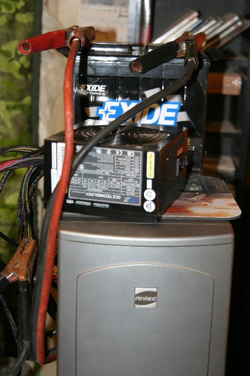

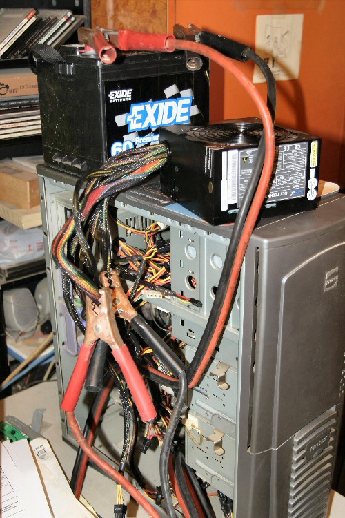

This thread is soon to be two years old. However, in the interest of contributing something of value I have attached a few images that clearly show my solution to the power demands of today's graphics cards! Graphics cards rely on 12 volt power! Simple enough. I should point out this method works just fine. :)
Ron

I've investigated the possibility of using multiple power supplies for quite some time now. At one point, I even found a couple products that will do the job. In fact, I found this review https://www.hardocp.com/article/2011/08/24/black_art_dual_psus_in_your_enthusiast_pc/1 of one auxiliary and one redundant power supply and two kits that allow multi-power supply configurations. I've been planning a gaming PC build for a couple months now, and have been unable to find a power supply that provides > 1300 watts from a retailer and manufacturer I trust. (I am quite particular about who I give my money to.) In addition, most of my electrical outlets (120VAC) are connected through a 15 amp circuit breaker. Considering monitors, printer, and allowing room for aging breakers, I probably wouldn't want to power much more than 1300 watts from one 15 amp breaker anyway. The obvious solution, that is the one not requiring house rewiring, is to split the load between a couple different 15 amp circuits.
I have a couple observations about this and other threads/forums which address multi-power supply configurations.
There is a misconception about differences between power and data connections within a computer system. To me, it seems incredible that even those who are otherwise knowledgeable with regard to computers, are apparently unaware that data lines from component to component in a computer are generally electrical connections with no real isolation. For example, it seems a common misconception that powering a hard drive from a separate power supply means the drive is electrically isolated from the motherboard, even though there is a data cable connecting the two components. Even if this is true of some special components, it is not standard design practice and as such, you must assume any component connected to the computer, either by power or by data lines, is not electrically isolated from the computer. Such an assumption could be both destructive and dangerous.
For example, consider a situation involving two power supplies powering different components on the same computer. Say PSU A is powered from a 120VAC 10 amp house circuit and PSU B is powered from a different, 120VAC 15 amp circuit, with ground +5V higher than PSU A. (Remember, voltage is simply potential difference from one point to another and ground is relative.) Now lets say we have a motherboard powered by PSU A connected to a hard drive powered by PSU B. At best, the motherboard chipset and hdd electronics won't be able to communicate and your system thinks the drive isn't connected. It is quite possible for the motherboard chipset to be destroyed though. Remember, the hard drive's ground is +5 volts to the motherboard, so when the drive tried to communicate, all of it's high data, the ones, were around +10v relative to the motherboard.
