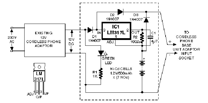

How To Make MINI UPS For My Digital Clock ?

I was wondering why nobody noticed the error in the circuit ? :confused:
The rechargeable batteries are connected to the wrong terminal of the
LM 317. :eek: I also added a 4,7µF capacitor to keep the thing stable.
