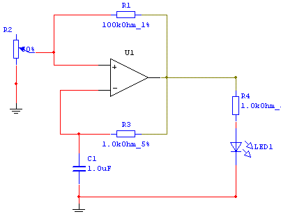

Is there a way i can use an opamp to solve this?? I want to use it in a ir remote control, so it need to be small. If I can use an opamp it would be the cheapes because i allready have a lot of them 8) .
Hi will this work in "real life" ?? It worked in pc simulation but....

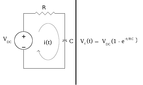

Miles, why did you include 2 ln(2) in the equation?
Shouldn't it just be 1/(2RC) for the frequency.
and if you just wanted to know the delay, dont even add the 1/ in the equation.

Most opamps won't work off 3V, the very simple (and cheap) multivibrator design posted above will happily work off 3V.
In fact, it will work off 1.5V - I built a signal injector probe back in 1971 that used a multivibrator and a single AAA battery. I used it at work for doing audio and radio repairs, the harmonics from the squarewave output easily work at AM IF frequencies, and even medium wave RF frequencies.
The astable circuit given in a previous post operates as follows.
When Q(1) goes into saturation, it connects the positively charged plate(s) of Q(2)'s timing capacitor to ground. If you ground the positive side of a capacitor, the opposite plate(s) must become negative with respect to ground. That negative voltage turns Q(2) off. This allows Q(1)'s timing capacitor to charge to V(cc) through R(c), ready for the next half-cycle. This occurs as the negative voltage at the base of Q(2) charges towards V(cc) through the base resistor. Once this voltage reaches ~0.6 V, Q(2) turns on, saturates, and forces Q(1) off. Each transistor therefore completes one cycle: t= t(1) + t(2). That would account for the factor of "2" in the frequency calculation.
Now take a LQQK at the enclosed diagram. This gives the situation which occurs as you charge a capacitor through a resistor. If you consider a capacitor charging to: V(c)= 0.5V(DC), and solve the equation for t, you will see that this becomes: t= RCln(2). If you drop the ln(2) term, then you will get:
V(c)= 0.6321V(DC), which is greater than 0.5V(DC). It will never arrive at that value, since the transistor will already have turned on.
Where: ln(2) is the "natural" (so called since these logarithms "naturally" give the easiest solutions to differential equations) log of 2. ln(2)= 0.693147180560 (approx). That's where 2ln(2) comes from.
