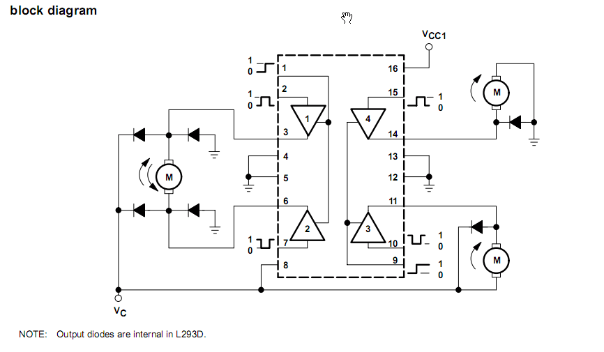

Assume the inductor is a 6v motor that spins both ways, so we have 2 x Zener diodes rated at 5.6v @ 1W, the most current the diode pass is 170mA. If we want to allow 100mA of current we use a 60Ohm resistor. In this circuit, is it right to use a resistor?
My reasoning for the 2 x Zeners is that if the motor spins both ways, the current that goes through the Zener will be the same in both directions, if we only had a diode then spinning one way would let the current through and spinning the other way it wouldn't.
Thats not the best way to apply back emf clamping.
Look at the LM293 datasheet, it shows 4 diodes for bi-directional

Hmm, that design routes the motor's current back to Vc and not to itself, isn't it dangerous to route current of the motor back to the battery? Instead of routing back to the Vc and ground why not replace both of those with a resistor (seems to work ok in the circuit simulator).

hi Alex,
No, it not dangerous using clamp diodes this way.
A resistor will not give the same protection a diode will, in clamping the back emf 'spikes' generated the motors inductance.

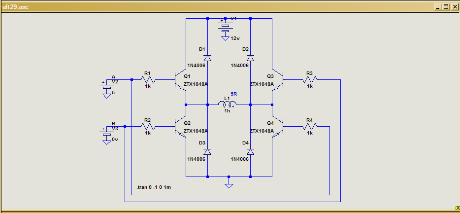

Thanks Eric I'll take your word for it. So below is my design with these changes. Is there anything wrong with it as far as you can see? (Ignore the green lines and the resistor values)
So when I put the first low to high, it circulates the current as normal, then when switching back to low, it circulates the current through the diodes to the Vc of the battery and then comes out from the Gnd of the battery back to the diodes. Also what's happening is about 1/5 of the current goes through the first transistor up the top.

hi Alex,
This is your circuit redrawn in a more conventional way for this type of circuit.
You have not indicated any voltage levels, so I have added what they might be.
Look at this circuit and tell me what are the problems and possible failures of your circuit.
BTW: get a better schematic drawing program, there a number of free ones on the web

Thanks Eric, that looks much better (I always keep drawing things going left to right :p). From what I can see a problem would be if both inputs were on it would short the battery. Maybe if the motor has been run and then the input stops there could be some damage to the transistors (is this right?). Is there anything else I might be missing?

hi Alex,
Consider the switching ON, of the 2 top transistors, when using a 5V logic drive and a 12V motor supply.???
BTW: the short you mentioned would be via the transistors.!!!
Hmm, so if Q1 and Q3 are both on at the same time, something would happen? If they are both on, there is no connection to ground so no current would flow? Or are you saying that because the supply voltages are different that something else would happen? I'm not too sure :S
In normal operation, Input A is on, so Q1 and Q4 are on, so current would flow from 12v to Q1, through the motor to Q4, then to ground. Input A current would go through Q1, the motor, to Q4 (and also come from Q4) then to ground. Would everything work properly?

Consider that Q1 is switched ON by the +5V to the base from 'A' what is the voltage you would expect at Q1 emitter.??
I would have expected 12 volts at Q1 emitter, but I've tried it in circuit simulator and it says 5V no matter what voltage V1 (12v) is. It seems to only pass through the current of V1 and not matter about the voltage. In a way it's kind of like a voltage regulator? Will it damage the transistor passing 12v at collector and then 5v at emitter?
Is there a way to make it pass through 12 volts using the transistor as a switch or would we have to configure the transistor in a different manner or just use one power source?

This is the reason I asked about the +5V on the base, remember for the transistor to be ON and conducting the base has to be about +0.7V greater than the emitter.
You will have to consider driving the top section in a different way, try to avoid having the motor in the emitter circuit, its not efficient.
Draw up a new circuit and post it.
