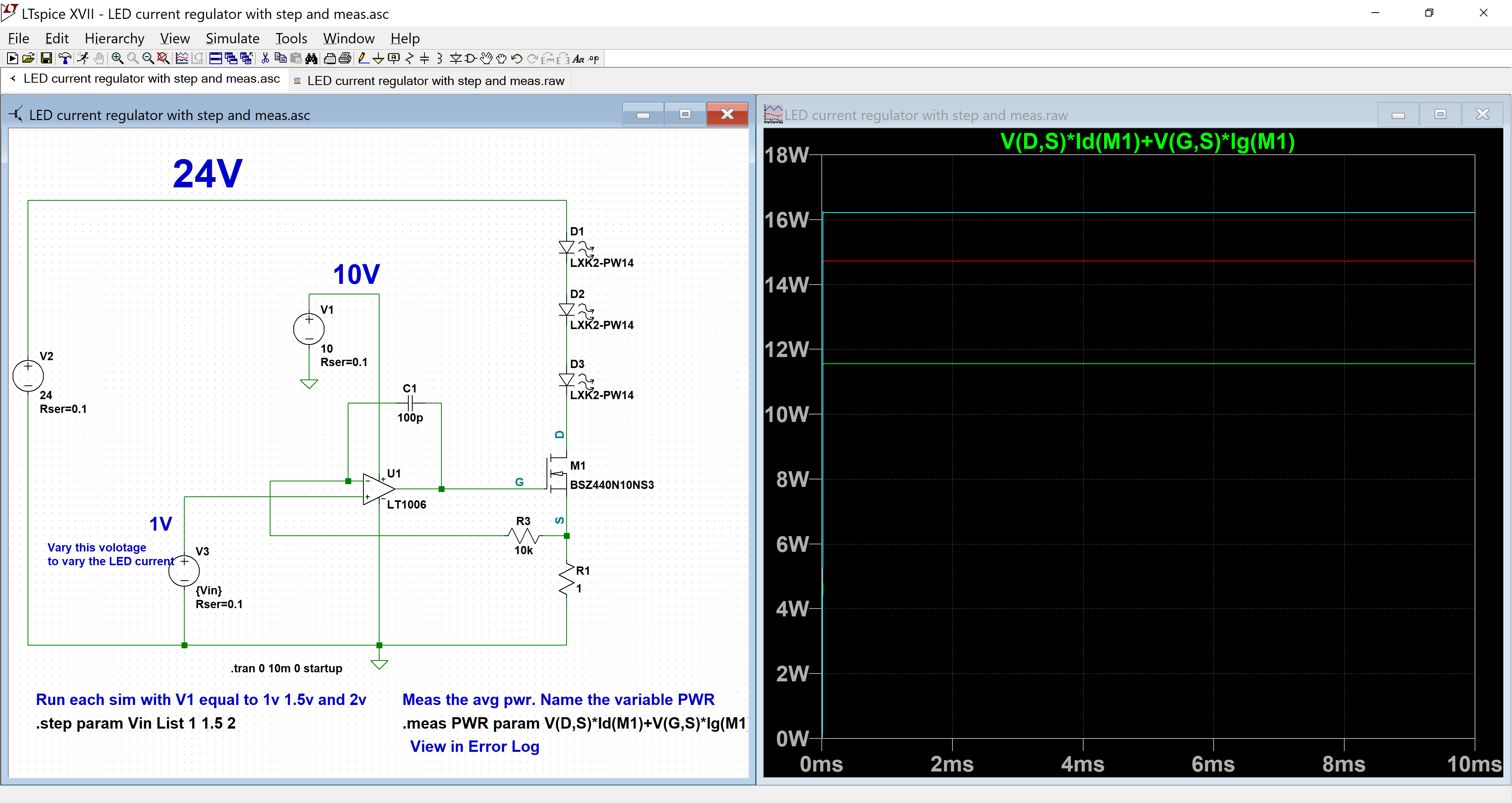

I wish to run LTspice simulations, and then automatically get an output from them which is eg the power dissipated in the mosfet in watts.
Eg in the attached simulation, “V(N007,N009)*Id(M1)+V(N006,N009)*Ig(M1)” is the mosfet power in watts, how do I get the simulator to automatically spit this number out after the sim is run?

Thanks yes, i appreciate that, the thing is i have another simulation where i need the sum of the power in 5 different fets, and i need a quick way of getting that number out of the simulator....without ALT clicking each fet and adding them all up.
Use a behavioural voltage source B with the function V=(V(N016)*I(R1) + V(N017)*I(R2) ) + ..........) and plot the output of B, then export as text if you want.
Use the “.meas” directive with the appropriate equation. You can then view the results in the error log. You can also use “AKA” and step to perform a simulation on multiple mosfet models. All the results will be in the error log.
Read “measure” in LTspice help to become familiar with it.
Pointing with the mouse for measurements is not only a pain but imprecise..:(

Here is an example:
119722
Notice that I named the wires G, D, S. This is to use friendly names and to prevent the wire names from changing.
