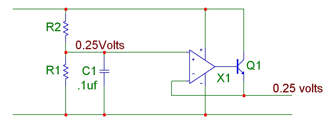

I can see you do not have a negative voltage so: see attached file.
You must choose the correct op-amp. Most op-amps will not work with their inputs near the same voltage as the supply pins. ( If the power supply is 0 to 12 volts then many will not work if either input is less then 2 volts or more than 10 volts.) You need to look for an op-amp that has a “common mode input voltage” that includes the negative supply. There are some amps like that, you might start out looking at MicroChip for low voltage op-amps.
That's the circuit I would use an LM324 in. Sorry I didn't provide more detail...
There are two problems with that circuit.
One, you need a 0.25V reference to give you the 0.25V output.
Secondly, the ADJ pin needs -0.25V to give 1V, your circuit gives +0.25V which would give an output 1.5V.

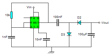

Like I said before, you need a negitive supply which can be made form a 555 and a couple of diodes and capacitors.
If you take ronsimpson's circuit and set the reference to 1 volt, you have a 1 volt supply. No LM317. You do need to supply the R1/R2 divider with something stable enough for the output that you want.
Which is fine to use without a booster if you only need 20mA.
