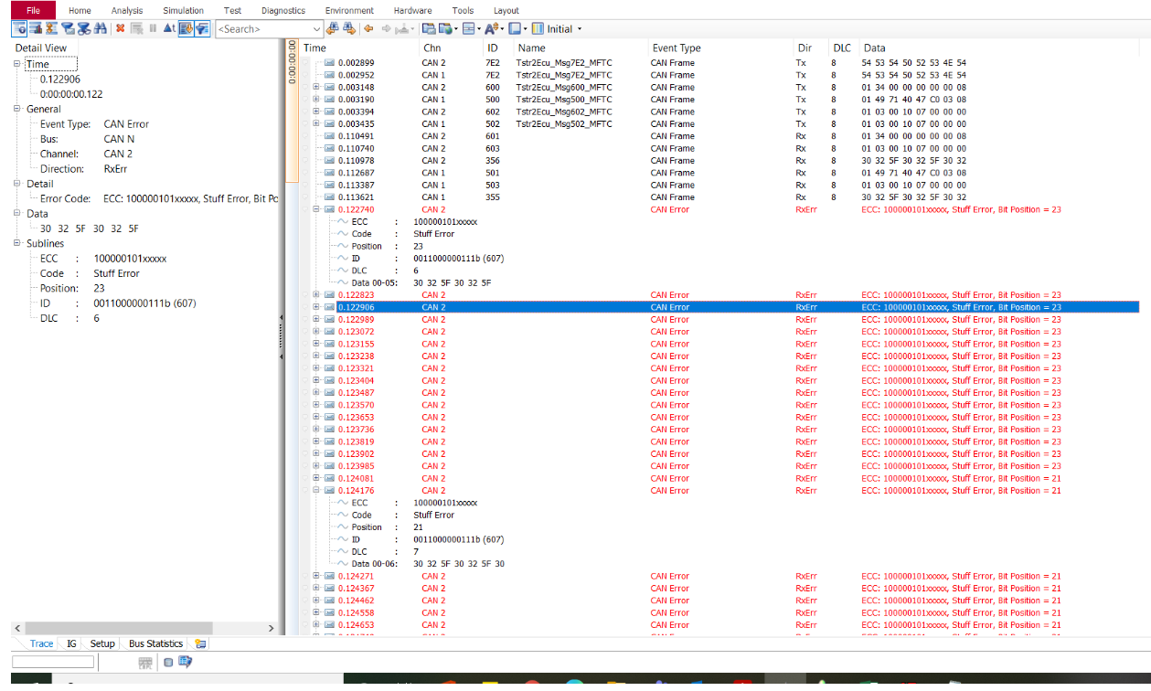

Our ADAS Controller is based on Renesas RH850/U2A16 Microcontrollers. We are using Infineon TLE9255WSK Partial Network CAN Transceivers. We are using Vector CANoe Professional.
When a CAN message is transmitted on CAN Channel 2 from our controller to Vector CANoe, there is Bit Stuffing Error. Please see attached filename Bit_Stuffing_error_CAN_Trace.PNG.

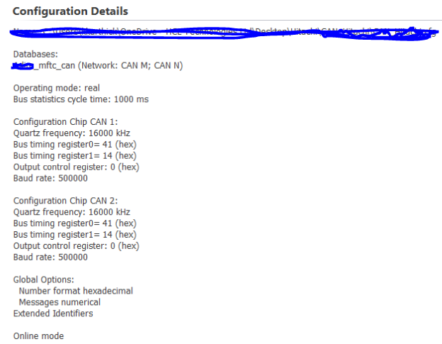

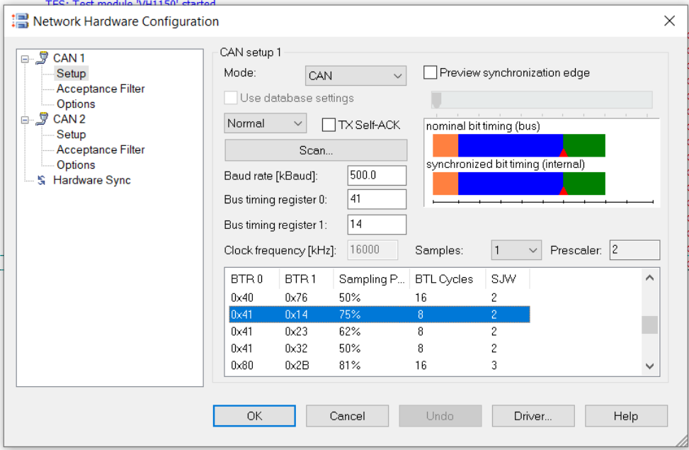

Also, attached are files that show our Vector CANoe tool configuration.

The problem occurs with Two specific standard CAN Ids. One is transmitted on CAN 1 to Vector CANoe tool and the other is transmitted on CAN 2 by Vector CANoe tool.
Clock frequency / bit rate errors?
If the bit timing drifts enough, one device relative to another, that could cause many problems..
Conventional CAN and CAN-FD use different bit-stuffing rules.
Is everything setup to use the same mode?

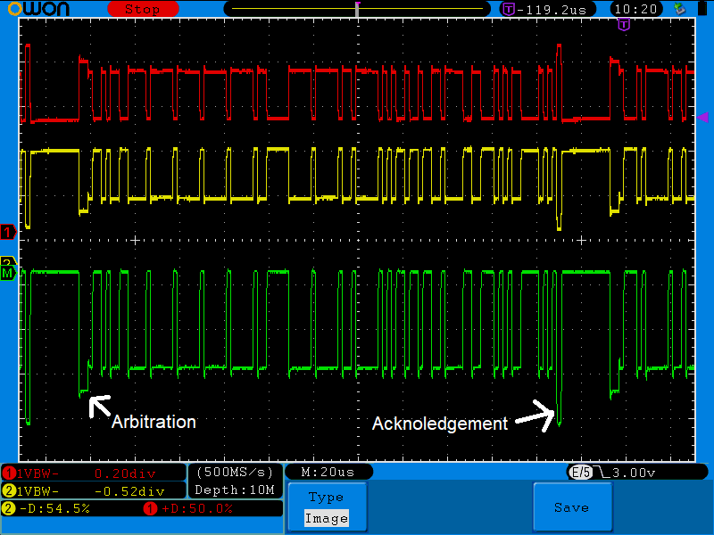

Oscilloscope traces can be very revealing. During arbitration more than one node will be transmitting 0 at the same time. Frame acknowledgement results in a single bit 0 being transmitted by all the receiving nodes at the end of the frame. At these times, more than one node transmits a 0, and this will result in a larger voltage difference between CAN-L and CAN-H than when a single node is transmitting. An oscilloscope trace will show when different numbers of nodes are transmitting.
It is also possible to see the difference between the voltages produced by different nodes, especially if the transducers come from different manufacturers.
The Vector tools can only see 0 (dominant) or 1 (recessive).
The green trace is the difference between CAN-H and CAN-L. The red and yellow traces are CAN-H and CAN-L. They are offset slightly, and the actual voltages of CAN-H and CAN-L are nearly the same during recessive bits.

What are vertical settings(volts per division) for each of Three channels above?
>> Frame acknowledgement results in a single bit 0 being transmitted but all the receiving nodes at the end of the frame.
What about the receiving nodes at the end of the frame?
I had a typo. I meant "Frame acknowledgement results in a single bit 0 being transmitted by all the receiving nodes at the end of the frame."
They are all 1 V per division. The zero marker are on the left.
Red is CAN-H. Recessive is 2.5 V or so, and Dominant is about 3.6 V if only one transducer is transmitting.
Yellow is CAN-L. Recessive is 2.5 V or so, and Dominant is about 1.5 V if only one transducer is transmitting.
Green is the difference between the two. Recessive is 0 V and dominant is around -2.2 V if only one transducer is transmitting.
I arranged it that way up so that the traces didn't overlap on screen.
I've just noticed that the bit stuffing can bee seen in action in this trace. Between 30 μs and 80 μs after the start of the frame, there isn't any data to send, so the values are zero, which is dominant. Every time that five zeros are sent, a single one is sent as a stuffing bit. Stuffing bits are needed five times at the start of data in this frame, and possibly a couple of times near the middle.

The transducer is the IC that actually connects to the CANbus wires. The node is the entire electronic module. I referred to the transducers because the voltage levels depend on the characteristics of the transducer ICs, and little else.
On the oscilloscope trace, the larger amplitudes during arbitration and during acknowledgement show the larger amplitude. During arbitration there were probably two transducers asserting a dominant level. During acknowledgement, there may be as many as 10 transducers asserting a dominant level.

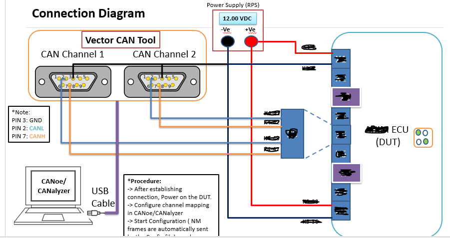

A diagram would be helpful.
Vector CANoe devices will be use to fault-find CAN buses, so a bus has to work with our without the Vector CANoe. The normal arrangement is a number of CAN nodes, at least two, on a twisted pair of wires, and a 120 Ohm resistor at each end. Along the wire there can be any number of nodes.
The Vector CANoe will just be one of the optional nodes on the bus.
The Vector CANoe devices will often have multiple ports so that they can fault-find multiple buses at the same time, because many cars have multiple CAN buses. However, it you have just one bus to fault-find, you just connect to one port of the Vector CANoe device.
If you had two buses, with CAN 1 transducer connected to one port of the Vector CANoe, and CAN 2 transducer connected to the other port, you would need four resistors. However, the system would not connect anything if the Vector CANoe device were removed.
If the CAN buses are only there to connect to the Vector device, and they don't go anywhere else, you might need a termination resistor on each bus.
