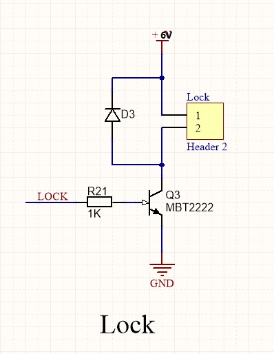

However, seems like I am having problems now with the transistor drive circuit. I think I am most likely using the wrong transistor and resistor. Can someone advise how to choose the correct transistor to use?
Currently I am using the MMBT222A with the base connected to the microcontroller pin with a 1k resistor in between. The microcontroller when high, gives 3.3V. The emitter is connected to ground. The collector is connected to the negative terminal of the solenoid and the positive is connected to 6.5V (from the boost converter). I have a diode connected across the solenoid.

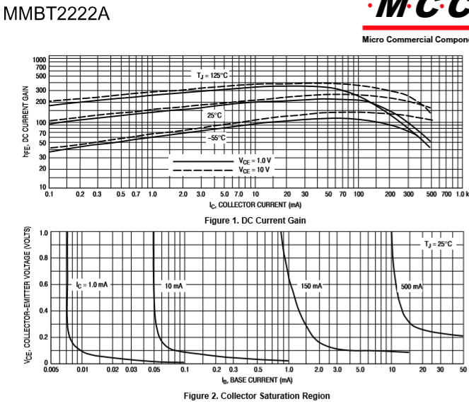

The specs on that look pretty poor, low gain and high voltage loss collector to emitter, assuming someone can suggest a suitable small power FET that's 3.3V logic compatible that could well be a better choice. However, for now, you could try getting more base current - lower the value of the 1K - what is the max current out of your I/O pin?. 100 ohm should provide about 26mA drive, which will at least give the transistor more chance of turning ON a bit.
Here is why the transistor will not work/gets hot/ and how you can see why.
Your poor little transistor needs to switch 800mA. Top graph shows collector current verses gain and the graph does not go to 800mA. The gain will be about 10. (gain is input current and output current)
Go to the second graph and look at the 500mA line. You wan the transistor to close to the 0.3 or 0.2V mark. To do that you need 20-50mA in the base. Your computer probably can not deliver that much current if the resistor was zero ohms.

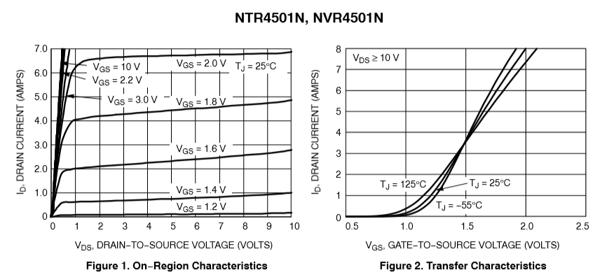

Logic level MOSFET:
I picked a part that 20V 3A and has a good gate.
MOSFETs are turned on by voltage not current. Left graph shows what happens with 1.4V from Gate to Source. The D-S stays closed below 1/2A and tears open above 1/2A. At 1.8V G-S the part can stay closed up to 4A.
120216

Most MOSFETs need more than 3V to turn on well!!!
I would use a 22 ohm resistor or some value from 10 to 100 ohms. It will work with out a resistor.
