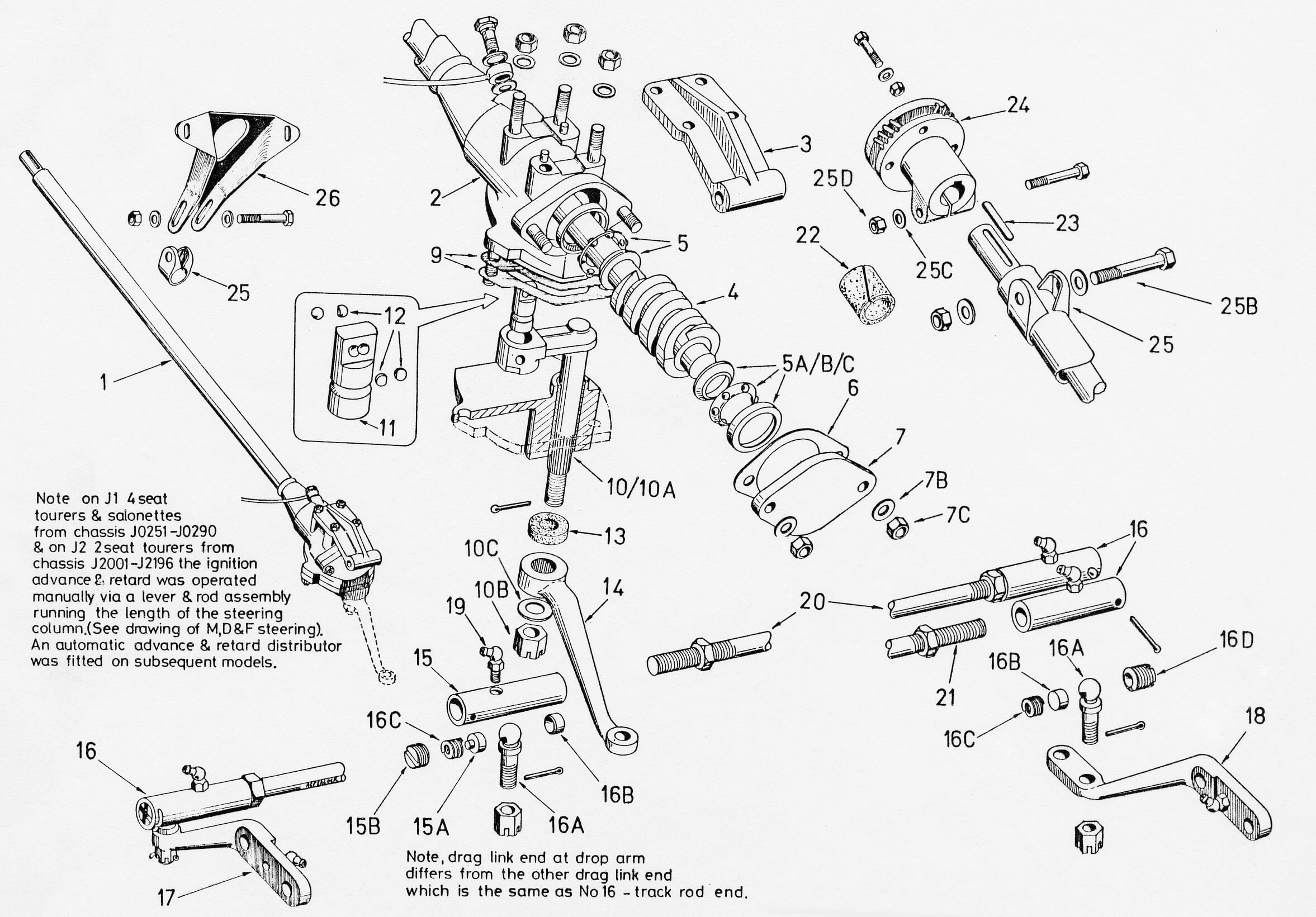

Look here:
My first car, a 1935 MG PA had a Marles-Weller steering box with a spiral "worm wheel" (item 4) which engaged with a peg (item 11).
The steering would self centre with the castor action of the suspension, and manually moving a front wheel would turn the steering column/wheel no problem.
It took about 1.75 turns lock to lock on the steering wheel,
power assistance? not required, beautifully light steering on 4.50 x 19" tyres.
(wishing he still had the car)

That's what I'd consider to be a conventional worm drive - metal on metal, no special feature to reduce friction between the worm and wheel.
Jim's example has bearings set in the follower "pin" for friction reduction; it's not a design I'd seen before, but has the feature to allow low-loss back drive.
This is a style I'm more familiar with (my older brother is a Jaguar specialist..) - Recirculating ball, effectively a ballscrew & nut system:
Just a quick note, the bearings in the pin are not spherical balls, but hemispheres.
The flat side of the hemisphere contacts the worm, and the round side fits into a round recess in the pin.
