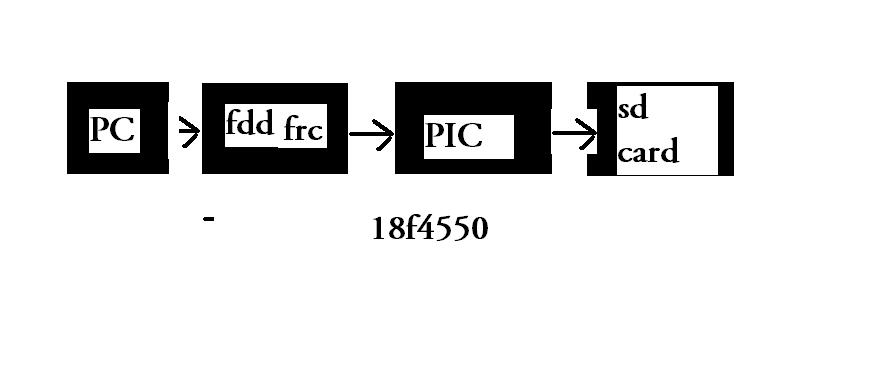

I need some inputs in creating a "virtual hardware" FDD drive using some SD card and a PIC micro controller.I have a PIC18f4550 with me and i know it has sufficient RAM for the SD interface? then how do I confuse the windows to have a FDD present in its hardware.. 1.44 MiB is enough for me. any help?

I did an interface with the SD card once suing PIC 18f4550, but the problem is, as the floppy drives are now obsolete, there is a severe short supply problem here. even for the usb ones. if i can some how make an interface which "confuse" the windows that there is a floppy drive then my requirement is fulfilled. its an odd requirement, but the time and $ for developing new software for a small need is far far greater.
