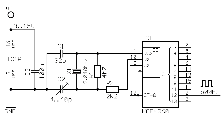

P parthiban31288@gmail.com New Member Jan 18, 2011 #1 FRIENDS.. i need to create 500Hz CONTINUOUS square wave signal.. which circuit is used to achieve this... better i need new technology or new ic..... other than 555, 741 and all....
Boncuk New Member Jan 19, 2011 #2 Hi parthiban, first off, it's not advisable to publish your full email address. (SPAM) Here is a circuit which you might want to use. Connect pin12 to ground. Boncuk Attachments 500Hz-OSCILL.gif 15 KB · Views: 350 Last edited: Jan 19, 2011
P parthiban31288@gmail.com New Member Jan 19, 2011 #3 thanks a lot... i have one more doubt.. it is suitable for continuous pulse transmission or not...
SABorn New Member Jan 19, 2011 #4 parthiban31288@gmail.com said: it is suitable for continuous pulse transmission or not... Click to expand... See no reason why not, circuits dont take holidays.

K KMoffett Well-Known Member Jan 19, 2011 #5 parthiban31288@gmail.com said: thanks a lot... i have one more doubt.. it is suitable for continuous pulse transmission or not... Click to expand... Maybe you can explain what you're trying to achieve...the overall goal...the big picture. Sometimes it's easier for us to help solve your problem, than help solve your solution. Ken
