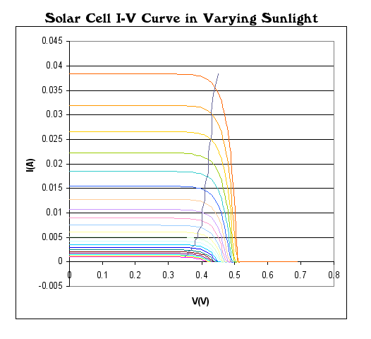

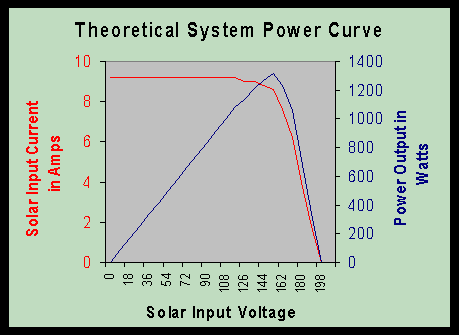

It is not so much impedance mathing as it is mathing the load to the solar panel. They have a power curve like this:
So for a given amount of light there is a best place to run it to get the maximum power. To always know this point is a moving target depending on the amount of light hitting the panel. That is why maximum power point is expensive.
So usually what is done is a panel is selected to provide more than enough power for the load. In your case probably 0.5 amps at 5 volts.
Or the charger simply shuts off if there is not enough light.
And yes it wastes power, but it is easier.
To do what you suggest requires MPPT. It is best, but not easy.

Solar Panels are more like a constant-current source if operated above the "knee" voltage.
Hi MikeMI,
So solar panels behave more like constant current sources, as we can see from the I-V curve that ronv provided.
Now, I am still slightly confused about this point: providing the correct voltage to the device and providing the most power possible. Once we provide the smart phone with the correct voltage by using a boost regulator that converts DC-DC, the phone should draw its own, needed and sufficient current, automatically...
Where does the max power transfer play a role then? Why do we need that or the MPT? It seems that the voltage booster would suffice....I am missing something
