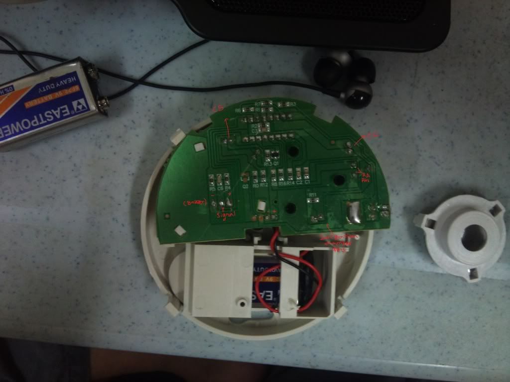

I check the voltage of the buzzer and the ionization chamber . It is not constant which fall below 2.5v.
This is the smoke alarm interrior,
https://i281.photobucket.com/albums/kk239/alexyee90/DSC01246.jpg
https://i281.photobucket.com/albums/kk239/alexyee90/DSC01264.jpg
And there are some small resistor with label code :
R7 = 228
R6 = 104
R1 = 104
R3 = 102
R2 = 755
R13 = 5R1
R5 = 155
R4 = 683
R0 = 0
R12 = 102
R8 = 472
R16 = 472
R14 = 102
R11474
Doen't know wht all the about .
Hope these info able to help out in modify the circuit .
Colin55 , yup the problem is i dont know want where to connect solder/ connect the jumper wire so that it can send signal to my pic . thx
