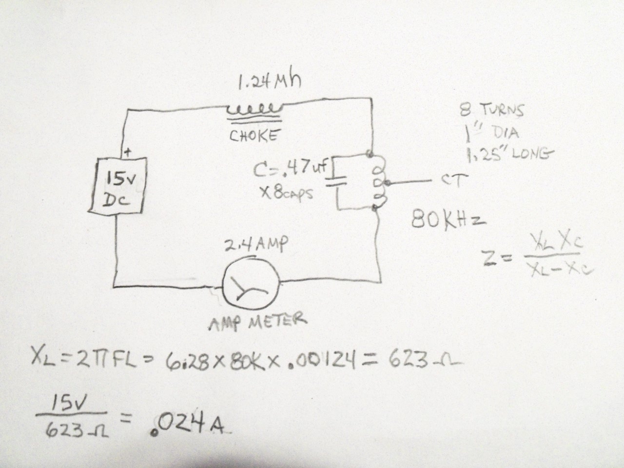

WHY is math wrong on this circuit???
Circuit drawing is correct. Meter showed choke 1.24mh all day now that i take a picture meter reads 1.35mh. LOL.
I am testing new power supply with old circuit, I picked the wrong mosfets for the new circuit. I am trying to get the correct value choke before I use it on the new circuit. I can make choke correct by trial & error but I would rather do math to get it correct. New mosfets can handle 37 amps.

Is the circuit you show actually oscillating?
If not then the real impedance is just the DC resistance. So the current will be limited by the total DC loop resistance.
Also the ammeter you show is a DC model.
YES the circuit is oscillating at 80KHz with NO load. Idle current is 2.5a. If I put a 1/2"solid steel rod in the work coil current goes up to 15 amps the frequency drops to 41KHz..
Amp meter is connected in series with DC power supply and the oscillator circuit.
Choke was not connected to the circuit when tests showed it to be 1.24mh.
