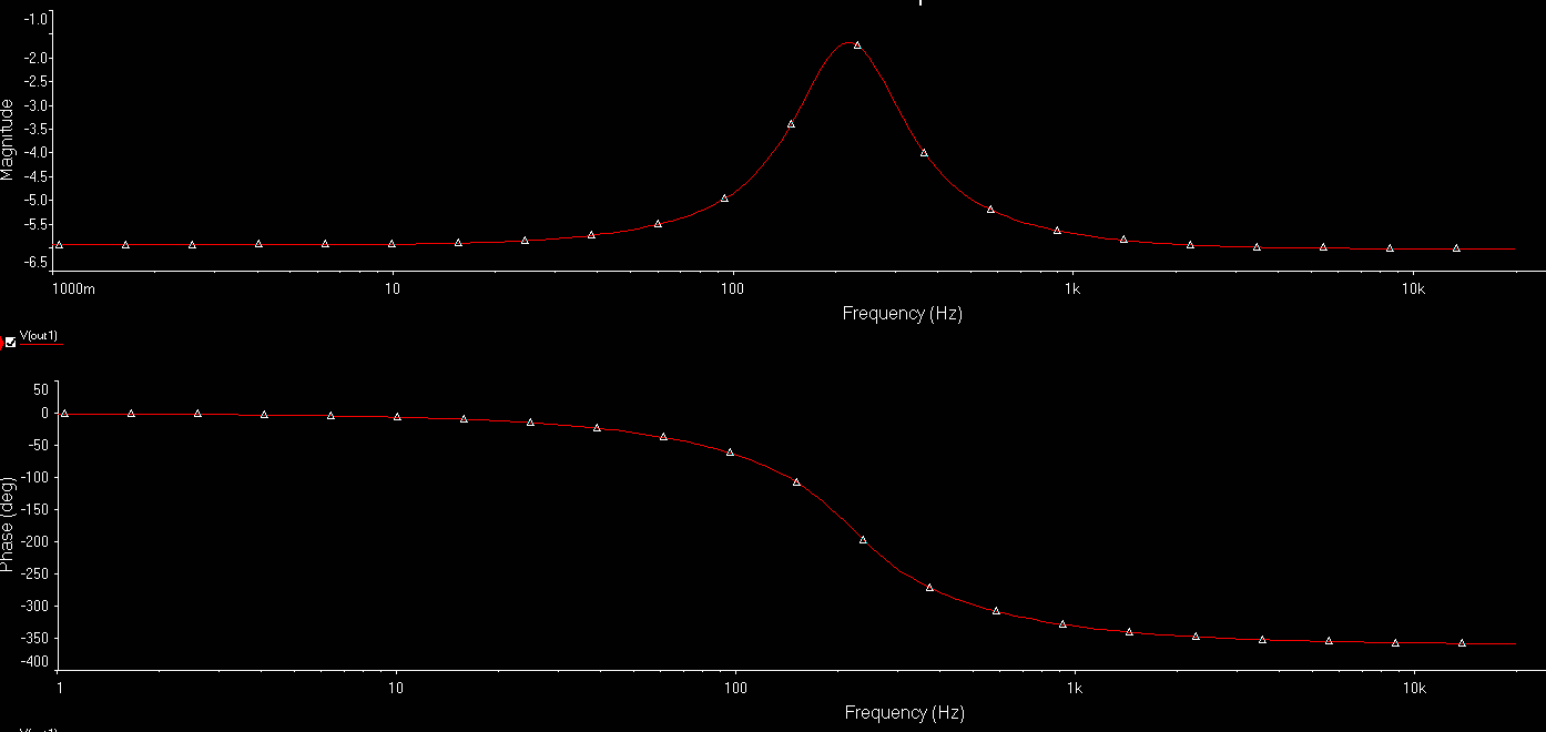

With a DSP filter you can program any filter shape you want with any phase shape you want. With simple electrical networks this is harder to do. Possibly use the Bessel type with two All Pass filters designed to 'correct' the phase of the output of the low pass and high pass. That would mean the summed output response would be more dependent on just the amplitudes and less on the phase. That might get you there.
just found something that in speakers Bessel should be avoided, Butterworth for uneven and Linkwitz for even orders. This may be more for passive filters. But the simulation for Bessel had the biggest dent at the corner frequency from memory. Luckily in an active filter its easier to change elements. Maybe should wire in potentiometers first and once its sortes, get the proper velues. Otherwise eventually the paths in the PCB bord come unstuck.
Building digital filters from scratch, hm, maybe can score one on ebay. Changing frequencies would be way easier then. Maybe I have to go for 4th order, 3rd gets 270deg, does not sound like a good plan. The original plan used 24 db filters that can be set via dip switches or so. But I tought 4th order is not that good at the corner frequencies. Some wavieness. Have to find that article and post a scan. Sidetracked with that rebuilding of a house.
The reason i suggested Bessel for your particular case is because it has a more linear phase response which can then be compensated for with the All Pass filter. The other types have a sharper phase transition near the cutoff frequency which would be harder to fix.

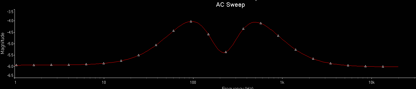

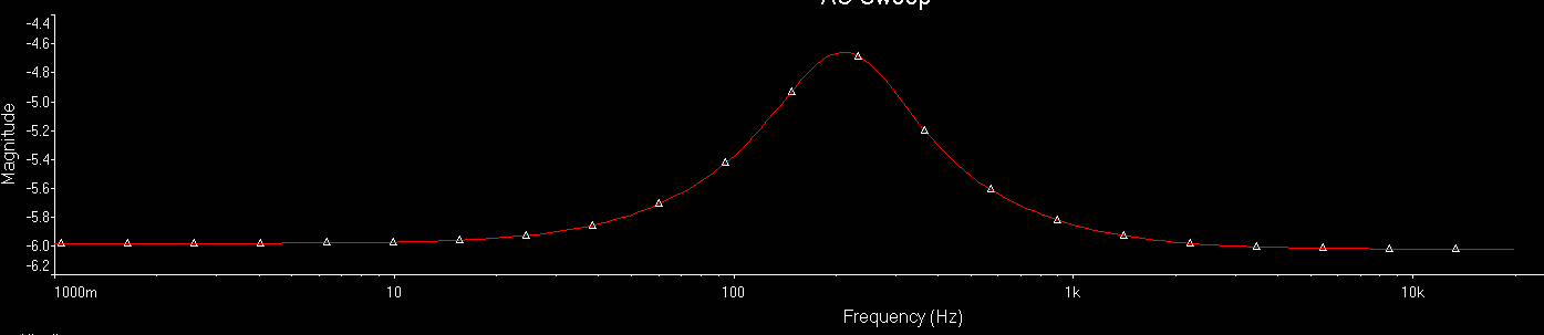

if I was to do it as 4th order it actually come out alright. Lowpass to 241 and highpass to 204 Hz.Most likely they went for Linkwitz.
