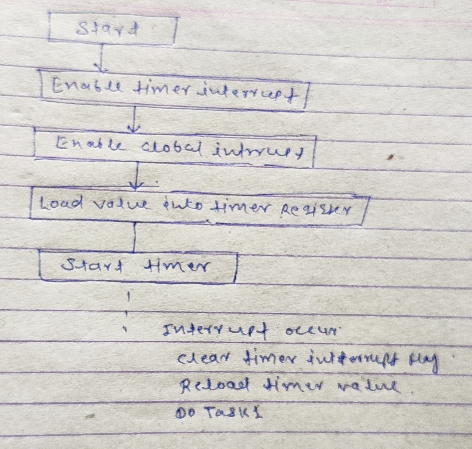

I do not understand how different tasks will be executed on each interrupt
For example, interrupt occur at every 5ms
When Frist interrupt occur, do the first task
When second interrupt occut, do the second task
When third interrupt occur, do the third task
Repeat whole process
Here is my idea how first interrupt occur and finish his work in ISR but I don't understand how and when second and third task will execute?
It's up to you what you do with the interrupts, you need to program the ISR to do as you wish. Bearing in mind that ISR should preferably be kept as short and fast as possible, and avoid calling subroutines if you can.
A fairly common solution is to use 'flags', so the first time the interrupt gets called set flag1, the next time set flag2, etc.
The main loop then polls the flags and responds accordingly, resetting the flags in each relevant routine.

Simply increment a counter, when it equals ONE then set flag1, when it equals TWO then flag2 etc. When it gets past the highest value rest the counter to ONE.

Nigel said 'flags'. I would have used the word "task counter".
First think in the interrupt code:
If Task_Counter=2 then Task_Counter=0 and go to task code 2,
If Task_Counter=1 go to task cose 1

I suggested 'flags' so as to keep the ISR short and fast, and run most of the program in the main code - rather than running everything from within the ISR.

This question is related to interrupt. threading will be very advanced topic for me. I don't know about it. I do not have clear understanding on the interrupt right now, so I would not like to go to the advanced topic.
