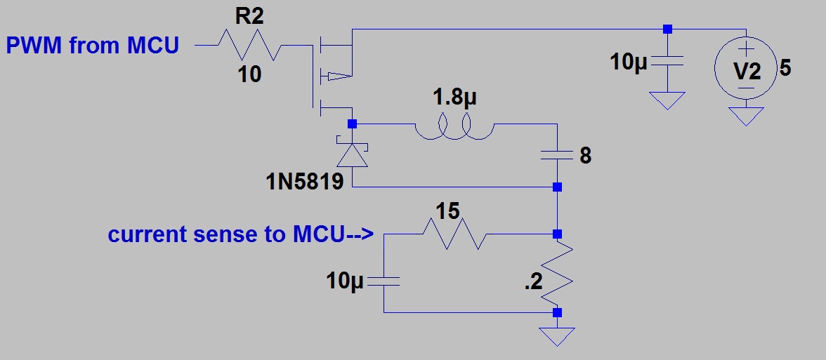

so i have a pFET, IRF9Z34N, Vsource = 5v, and a DIO pin that goes 0v and 3v. the pFET has a threshold voltage of Vgs = -2 to -4v, and an input capacitance of 620 pF. will the pFET turn all the way off at 3V? and should i have a pullup between the source and gate? (the DIO is a 5v tolerant pin). i need to switch it on and off at 500kHz.

yeah i didn't think of that. the whole circuit is:

  • buckP500k.asc
DAMN i screwed it up again! the current sense signal is measured at the capacitor. hold on....
OK, it charges the supercap and monitors the current going through the circuit and continually adjusts the PWM duty cycle so as to limit the average current draw from V2 to 450mA. this circuit already works fine when it's connected to an arduino board controlling the PWM, but that's a 5v board. now i'm using a discovery evaluation board https://www.st.com/content/st_com/e...tm32-mcu-discovery-kits/32f0308discovery.html and today i modded the board so now it runs on 3.6v.

Hi MW,
i'm not sure what you mean by a shaping resistor. Is that the R2 resistor? for rounding off the square input?
The gate resistor performs a number of functions but, in essence what you say is correct. The gate resistor should be physically as close to the gate terminal of the MOSFET as possible, ideally connected directly to the gate terminal of the MOSFET.
On a separate subject, the PMOSFET gate drive. As has been said, a driver chip is really the only way to go at the frequency and current in your circuit but, at the moment, going by your schematic of post #14, you are driving the gate of the PMOSFET from a 3.3V MCU.
Can I suggest that, until you have time to get a dedicated driver chip, you make a driver with a high conductivity NBJT; a BC337 would be ideal.

Also, on your schematic of post#14, can I suggest that you make the 15 Ohm resistor 4.7K and the 10uF capacitor a 100nF disk ceramic capacitor. That will protect the current sense input to the MCU better and also improve filtering.
