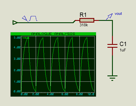

can someone explain why the output voltage of the following circuit is showing near +5V? the input signal is pulse signal of 5V and 0V. After the resistor there should be voltage drop and from my calculation the output voltage should be somewhere near 2.5V for high duration.

As there is no resistive load across the cap to discharge the cap, it will charge to 5v, assuming that the 5v source impedance is high.

i connected a load resistor of 1Ohm and 10Ohm across capacitor but the voltage there is just micro volt range!
You have a voltage divider with a 300k and 100r resistors. Microvolts is what you should get.

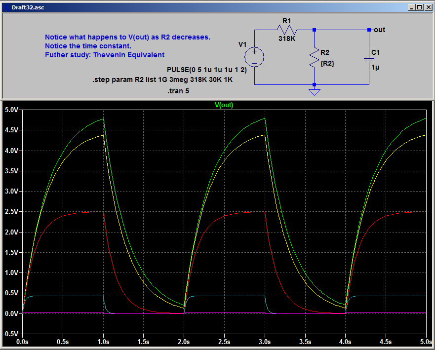

The load R2 is part of a voltage divider with R1. The filter is calculated by first combining R1 and R2 (Rt= R1*R2/(R1+R2) using Thevenin's theorem. The voltage is based on the voltage divider R2/(R1+R2). Finally, you calculate the cut-off frequency by finding where Xc1 = Rt.
The reason I drew the schematic the way I did was to remind you that R2 has to be considered first before worrying about C1.

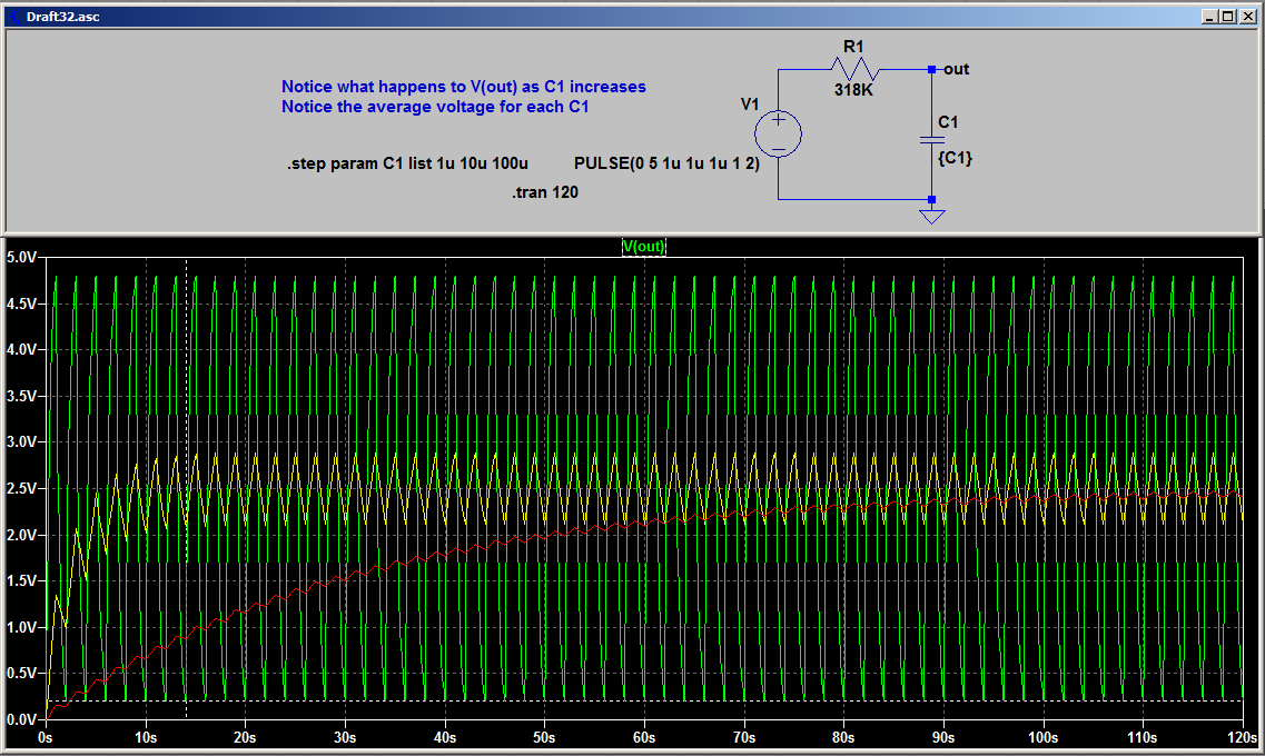

V1 has a duty-cycle of 50%. What would happen if it had a duty cycle of 10%? What would the average V(out) be then?

Using your posted plot, you can see the 2.5V point of the cap charging voltage occurs at 0.22Secs, as you would expect.
E
