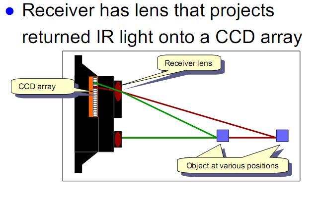

The optics dont form a true image on the CCD just an illuminated area offset at an angle from the source.
The GP2D12 outputs a signal proportional to this offset which is related to the angle.
Using fairly simple trig from these angles a range/distance can be calculated.:p
That's not a bad picture. They've even got the trasmitted beam at 90' (which is correct) lots of the pictures you see for the sharp sensors get that bit wrong.
If the transmitted beam is at 90',well, when it meets a perfect plane surface, as the picture shows it, how can it be reflected with an angle different from 0?
Oh yes, you are right, I have forgotten that. But, if the surface is a plane mirror, well, does it mean that the captor can't calculate the distance?

Light is also reflected by the edge of a mirror - not it's surface.
If the object is within measuring range (4 to 30cm) you'll get a usable return signal.
One of the applications is the use for automatic pissoir flushing systems.
If the "echo" caused by clothes is strong enough for measurement a solid mirror edge will be, too.
Boncuk
Yeah the Sharp sensors will actually detect clear glass too, it's a bit of a problem. The datasheet says something about glass having to be very close to the sensor (under it's minimum range) to avoid issues.
I did some experiments here on the forum a couple years back testing the Sharp sensors to see the top surface of clear water, it was touch and go. They will return a reading from a clear surface.
