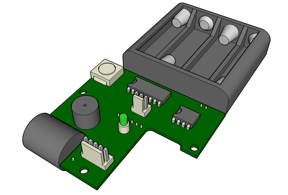

Oh yes; it's for the Armadillo lock on my site. Which is getting an I2C DS1307 RTC & 24LC256 EEPROM update at the moment

A CR2032 has about 210mAh @ 3v, a set of four NiMH cells would be 5v @ 2300mAh. I think I will use them unregulated with just a 1N5817 inline for reversal protection.
I plan to trickle charge the cells @ 1ma via a 4.7k pullup (the ibutton pullup) & diode 1N5817.
I've update the Armadillo .pdf schematic on my site with the trickle charging circuit.

I thought it might be a simple way of keeping the NiMH batteries topped off, the only time the circuit needs any real current is when you power up the motor or solenoid. If the charger circuit proves useless I'll omit it.
The charging circuit uses the same wire pair as the 1wire communications driver option (at the other end with a 4.7k pullup to 5v) The idea is you can request the lock to close (1way communications) by toggling the state of a DS2405 1wire I/O. The make / break connector allows for a simple conductor cable to be used for the 1wire bus. A device similar to the OWL on myblueroom could be used although any iButton controller should function. The make / break also will tell a remote reader if the door is open (no DS2405 present).
There are many commercial locks with iButton readers
Much like this design at $628 US
The initial Armadillo was designed as a swap in replacement for the Weiser Digital Powerbolt (now owned by Black&Decker). The motor inside is a cheap 6v toy motor that drives a worm gear & clutch. It's only powered for about a second, there is a delay then it relocks. The Weiser only holds 2 combinations.
It's grown beyond that (although it would still be possible to use a subset of the schematic in a Powerbolt) (Rev E of the Armadillo will have an EXIT switch option in the schematic).
