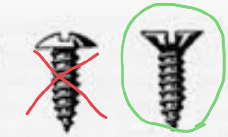

It is a lot easier to mount these with "wood screws" screws that have a bevel between head and shaft vs a flat head. . The angled taper between shaft and head give you a bit bigger range of "perfect" distance. The flat, 90° will ether be too tight and won't allow the strip to lock into place or it will be too loose (unless you get lucky.
It's called a 'counter sunk' screw, and is by far the most common wood screw.
The name "counter sunk screw" has not caught on in the US. They are generally known as wood screws on this side of the pond. Fortunately, many items with screws included in the package, often come with the cheapest fastener the manufacturer can find which may be sheet metal screws - like the image on the left in my post above.
Yeah that could help too. I was planning on using "Molly" bolts but not sure if that is going to work that well. I am leaning toward a 'backer strip with the top screw as per Nigel's reply. I'll have to figure out what to use for the backing too i guess.
