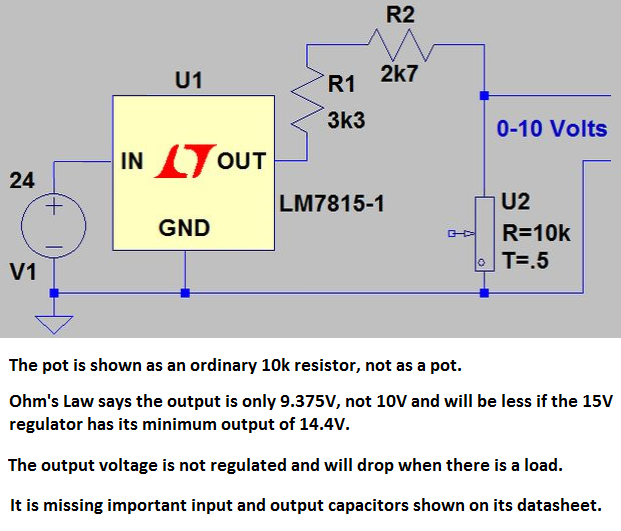

The **broken link removed** is a 0-10 volt simulator. I had one made for a 24VD supply with a 14K resistor and a 10K POT which worked fine but it was as inaccurate as the input voltage was so I thought I could make one with a voltage regulator to get a steady input and therefore a closer accuracy of 0-10VDC out of the POT.
What I get out of the 7815CT regulator is 15.06VDC without the 10K POT in the circuit but as so as I add the POT the voltage out of the regulator drops to 14.66 with the POT at maximum resistance of 10K. I also do not get the 0-10VDC I expected at output of what is a voltage divider between 5000K resistors(3.3K+2.7K) and the 10K POT. I only get 8.96VDC. Where am I going wrong?

What about the other circuit with the 10K POT, isn't the voltage regulator suppose to maintain its output to its specified voltage?
I got the first one working audioguru, just like you said I burnt the regulator. I worked well with a new one.
The second circuit is still not functioning the way I would like it to. I'd like the voltage to remain stable.
I didn't notice your schematics because I was distracted by the ads showing pretty girls with skimpy clothing.
The schematic with the 15V regulator missing important capacitors driving 3 series resistors is hopeless. Of course the voltage is not stable.

I was racking my brain trying to figure out how you came up with 9.375V!!!. As it turns out I can't add :D I added 2700 added 3300 to make 5000!

I simply used correct arithmetic (2700 + 3300= 6000) and Ohm's Law. The total resistance is 2.7k = 3.3k + 10k= 16k. 15V/16K= 0.9375mA. The 10k resistor with a current of 0.9375mA in it has 9.375V across it if it has no load, if the 15V is exact and if the resistor values are exact.
