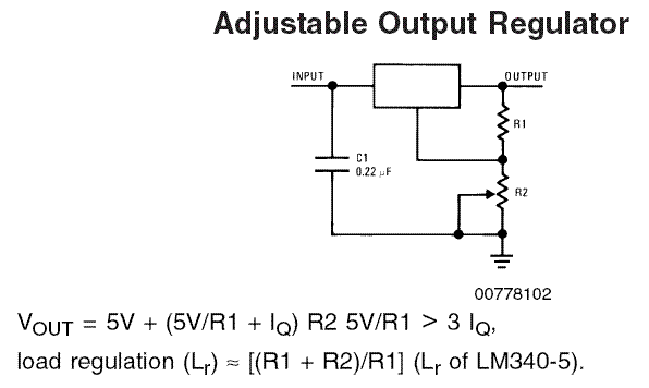

Since it's battery power just use them in series. This is a criminal waste of power though, this is the at least the third post in the last month that has inquired about using the 7805 for regulating voltages outside of it's design recommendations. Why don't people use just use a variable regulator with a 10 volt refrence or a dedicated 10 volt regulator?

hi sm,
Use the 7805 in Hero's circuit, make R1 about 270R and R2[pot] about 1K.
The regulation will not be as good as a LM317, but it will give you +10V, until you get hold of a LM317.
Or use the LM317 and use a 120:eek:hm:resistor for R1.
