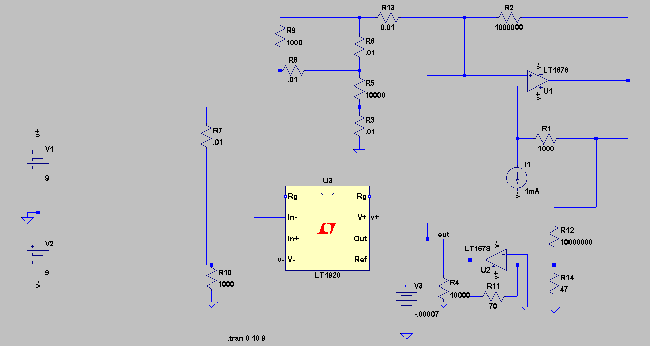

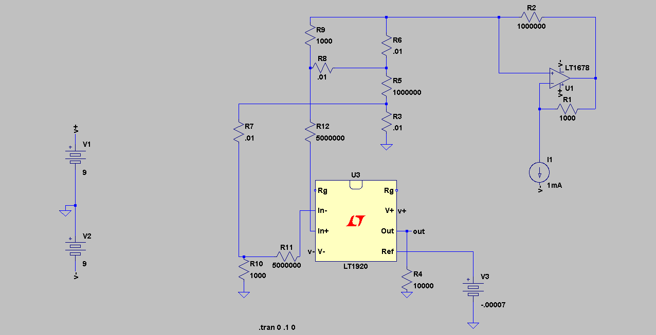

How do I compensate this error?
throbscottle
I've been playing with a design for a 4 wire ohms converter, and ended up with a simple ohms converter for force and an instrumentation amp for sense, which simulates beautifully for low values of resistance down to 0.1 ohms or lower, since the error can be offset at the in-amp's output, but it has an error due to leakage which at large values of resistance creeps up the scale. I'm looking at 6 digits of resolution and I'd really like the last couple of digits to be meaningful in the high resistance case.
Knowing that more errors will creep in in the real world, I'm trying to find the best compensation I can.
In the schematic, R5 is the DUT, R2 is the current-setting resistor, R3,R6,R7,R8 are the lead resistances, R9 and R10 are for automatic 2-wire/4-wire mode selection, R11 and R12 are to cancel the in-amp's input offset. The in-amp U3 will actually be an INA128 since TI are very kindly sending me a sample so it's input bias current will be higher than that shown. The gain of the in-amp is unity.
V3 represents an presettable offset circuit consisting of an op-amp voltage follower and a preset potentiometer connected to a voltage reference
I tried connecting U1's + input to the in-amp's output instead of to R2, but it made the problem worse. Other feedbacks get complicated quickly.
The best solution I can think of is to make V3 sensitive to the current through the DUT so that it changes the offset with each setting - I know it's not true compensation, but it's a "good enough" solution without something better. The easiest alternative seems to be losing a couple of digits resolution, which I don't really want to do.
So my question is, what's the best way to implement a self-adjusting V3, and is there a better solution? Should I be looking at a current feedback amp here?
Thanks everyone in advance, and happy new year!

The in-amp's gain is unity, so there is no Rg. (ie, Rg = infinity) I only looked up the input bias current, because I'll be using an INA128 anyway, obviously not modelled in LTSpice. As it turned out the bias current in the simulator is different from that in the datasheet anyway. It's actually acting as a buffer with differential inputs.
What I really need is a negative feedback way to compensate for the error, so that the in-amp's bias current won't be important, without applying feedback to the in-amp's input terminals. It can change either the output from the force circuit, or the output from the sense circuit, doesn't matter which, but I'm all out of ideas.

I hadn't thought of the sense circuit as an I-V converter, but of course that's what it's doing. What I did notice was that the current through the DUT is being changed by the in-amp's offset current. I guessed if I could compensate for that, then Vos wouldn't matter.
It really bugs me that because I've designed something which can in theory measure low resistances really well, (or at least, really well enough for what I need), it has become relatively poor at measuring moderately high resistances, eg >= 1M, which even a cheap handheld dmm can do reasonably well.
So is the solution to use the 2w/4w method shown for resistances up to about 100k, and switch sensing circuit, or part of it, when it goes over that?

Why do you have 5Meg resistors in series with the inputs? These, when multiplied by the input offset current, will yield an offset relative to the input of 1.5mV typical, 5mV max.
Can you explain how your circuit is supposed to work?
I was looking for ways to cancel the offset. I'd read about offset cancelling resistors for opamps, so I thought I'd give it a try for my in-amp. So for the simulation, the two 5Meg resistors are just values that gave the best improvement on not having any resistors there. I got the value initially by dividing the bias current at the inputs into the error at the output, and dividing the result by two. After that I just played with the values. I don't know much about op-amps, and less about in-amps, so this is all part of my learning process.
The 0.01 ohm resistors represent lead resistances. R9 and R10 provide automatic 4 wire/2 wire selection - in 2 wire mode R7 and R8 would be disconnected. The in-amp doesn't know anything about ground, so although it looks strange it should see each end of the DUT as a differential input - it was the only way I could think of to get the differential circuit needed to do 4 wire measurement and still have one side of the DUT connected to ground. At the moment I am limited to a FS of 1 volt.
U1 is part of an ohms to volts converter circuit, where R1 sets the voltage, and R2 is switchable in decades. The op-amp wants to make it's inputs equal voltage, so the current through R2 is a fraction of I1. This current appears through R5, which is the DUT, and is my first source of errors, since U1 takes a bias current, reducing the current through the DUT by this amount. This doesn't matter for low resistance values, but becomes significant when values of 1 Meg are approached, which is why I've shown 1 Meg in the diagram.
The in-amp creates errors of it's own due to input and output offsets. V3 is effective for cancelling the offset when the DUT is a low value, but becomes insignificant when a high value is tested.

I found a way to make the offset change as the dut is changed. Just need to properly work out resistor values since I just guessed and then jigged them around in LTSpice.
V3 is replaced by U2, R11, R12 and R14. When the DUT is changed the voltage at the output of U1 changes, and a tiny fraction of this is inverted and applied to ref input of the in-amp. So the output offset correction for the in-amp tracks the value of the DUT.
Some problems with this though - it's set up for an in-amp with a positive output offset. Don't know how this would work with a different device.
Also it's very sensitive to the values of the resistors - needs to be a bit more robust in that respect.
