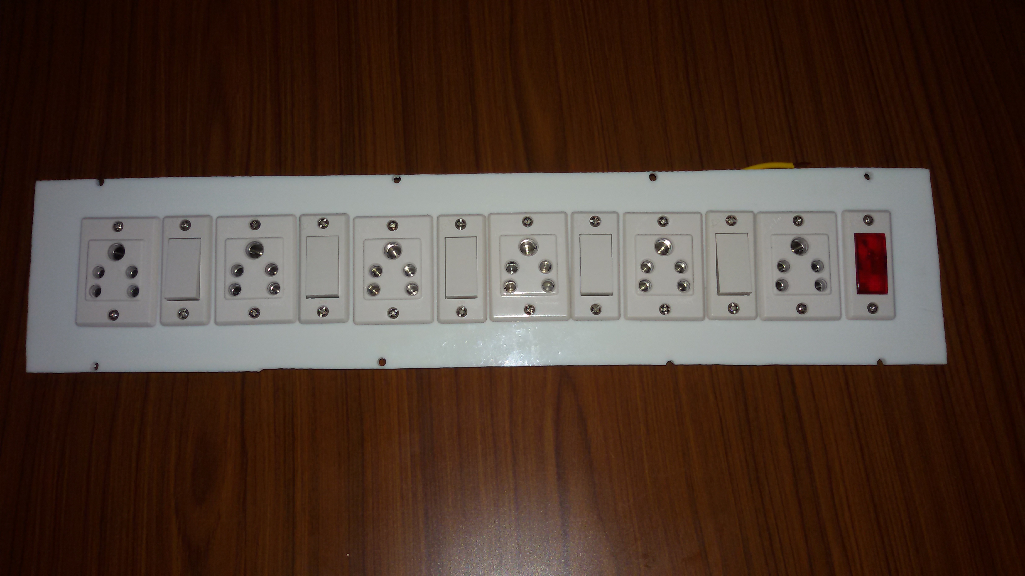

Hi All,
i am plan to wire and extension box for my microwave oven. i bought a 15 amp extension box with a 3pin socket,switch, Fuse and Indicator. I dont know how to wire internally.
Here are my assumptions
Earth wire goes to the third pin of the socket
Neutral wire goes to left pin of the socket
Phase goes to switch->fuse->indicator->right pin of the socket.
Is this sequence is correct? Is the phase should always connect to the right pin?
Is there any site for the Indian Electrical Wiring, where i can find the diagrams and standards for indian house wiring?
I am living in Bangalore, India
Thanks,
Mani
Just connect L (live) to the circuit breaker and from there to the L-terminal of the socket.
Connect N (neutral) to the N-terminal and PE (protective earth) to the PE-terminal.
That's it.
Boncuk
Attaching the photo of junction box. Please let me know,if it is this correct?

That is nearly correct. The power does not go through the red light. The red light is connected between the left and right pins.
What wattage is your microwave? 15A circuit may not be large enough. For example, if the microwave iw 2000W, and your mains voltage is 120V, then you have over 16A flowing through your circuit. You might want a little margin too.
The mains power in India is 230 or 240 V (I'm not sure which) at 50 Hz. The round pin plugs like that were standard in the UK until about 1960.
A 2 kW microwave on 230 V is far less than 15 A.
It is but you also have to consider that most microwave ovens have little to no power factor correction so even though it may draw around 2000 watts its VA rating could still be closer to 3000 give or take which then makes the 15 amp circuit more likely to be the proper size and capacity.
True, but the OP has a choice of 15 A or 5 A circuits. In fact, the smaller socket holes just below the main socket holes, are for a 5 A plug for smaller appliances. I didn't mean to imply that 15 A was the wrong choice of circuit. I only meant to say that 15 A could easily handle a microwave oven. 5 A would have been too small.
Thanks Driver300....It is working. I have done the wiring.
In India there is two option available 5A and 15A. The microwave oven will work 5A also but for safety we are connecting to 15A.
