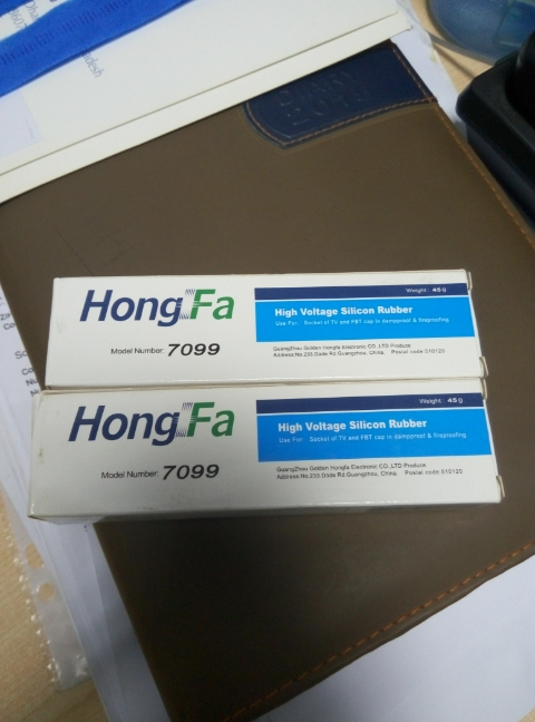

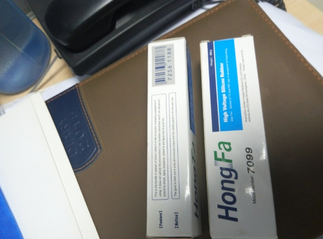

I bought the following item from a web site who claims that this product can be used as thermal paste (heat sink compound). I am really confused.
Bad info. it is the opposite of a thermal conductor.
this is an excellent thermal and HV insulator though for Flybacks >>25kV
