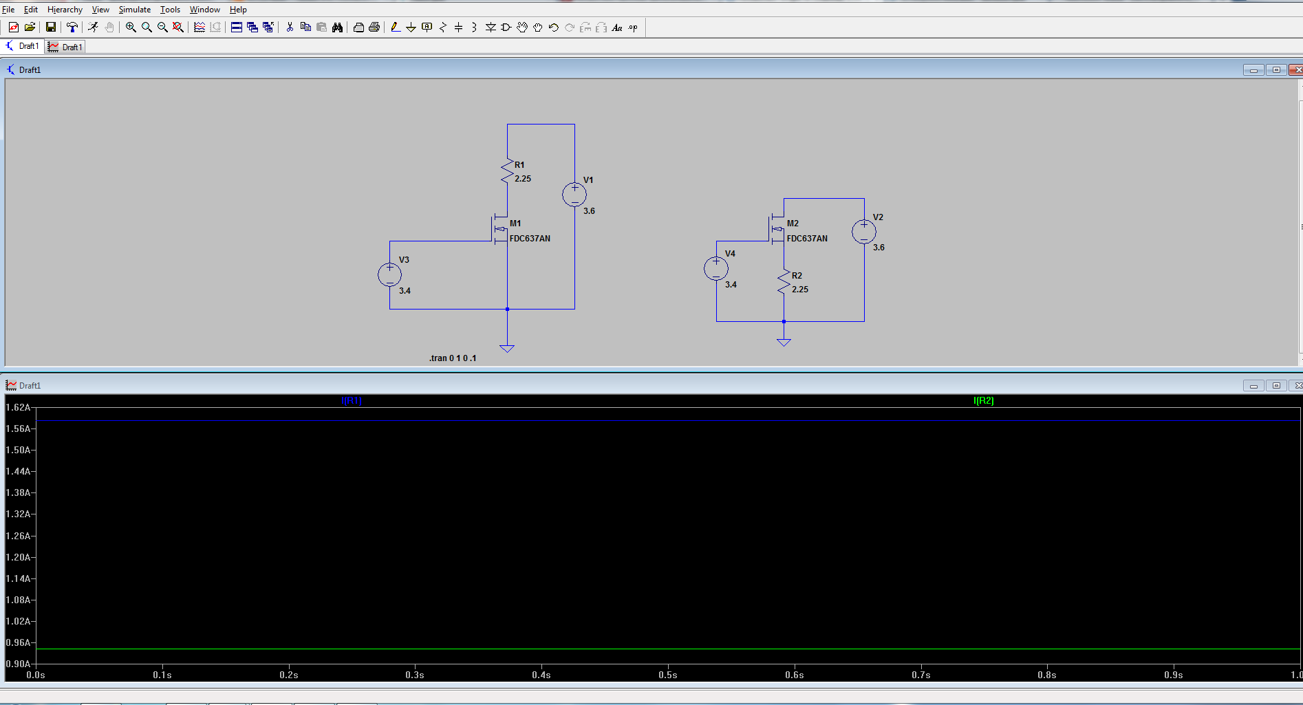

Hello All,
I am simulating a switch circuit using mosfets. I simulated two circuits. One with the mosfet on the low side and one with it on the high side. The mosfet is an NMOS FDC637AN. I chose this at random just because it was in the library. When the mosfet is placed on the low side the current is significantly higher than when placing it on the high side. When I do the math, it appears that the mosfet is in the triode region Vds<Vgs-Vth. Probing around the circuit Vds is .037V when placed in the low side configuration and 1.48 when placed in the high side configuration. I am stuck understanding why this is happening. Can someone please explain why the mosfet is able to pass more current when placed in the low side configuration? I have attached an image of the circuit that I simulated.

In the secvond circuit, the voltage at the source terminal of M2 is raised by the current through R2. This reduces the gate-source voltage to the mosfet so it doesn't turn on very well.
Change the connection of your V4 voltage source so that it's negative point is connected directly to source of M2, and you will see the two circuits behave about the same.
you are not turning on the high-side switch enough.
For high-side switching essentially the GATE must be brought Vth above the main voltage (in this case3.6+3.4 w.r.t. 0V) EITHER by having a larger voltage source OR via having a high-side driver, bootstrapped stage or a floating psu for the high-side switch

Thank you for pointing out that design. I connected the negative terminal of V4 to the source and the circuit performed exactly them same in simulation. Thank you for pointing this out.

In a nutshell, A bootstrap is a capacitor and diode that allows the gate voltage to stay the required voltage above the source voltage. You really need to learn this (read a lot) if your serious about electronics.
Back to the bootstrap -
1. A diode in forward bias from the gate supply voltage.
2. A capacitor of the correct value and voltage. The value is high enough to supply gate voltage for the "on" time of the high side mosfet.
3. One side of said capacitor is connected to pin VB of driver, the other to the source pin.
4.When the low side fet is on, the BS(boot strap) capacitor is charged to gate voltage through the diode.
5. When the low side is turned off, and the high side starts to conduct, the BS cap discharges into the VB pin of the driver, allowing the gate voltage to always be the correct level above the source voltage (Vgs). The diode stops the gate voltage from the BS cap from going anywhere but the VB pin of the driver.

Using Vth as the Vgs voltage to turn on a MOSFET is a common mistake. Vth is the point at which the MOSFET is just starting to turn on. To fully turn it on Vgs needs to be much higher, typically 10V for a standard MOSFET or 3V-5V for a logic-level type MOSFET.
never said just to use Vth ;) I always drive my FET's with +/-15V unless their gate cannot tolerate it.
What I said was the gate had to be taken Vth above the main voltage w.r.t. 0V I didn't say to
I have to agree that the high side has to be driven with a higher voltage than the power supply in order to get the MOSFET to turn on properly. This is a problem in all N channel inverters. Often we see P channel devices coming into play here intead.
