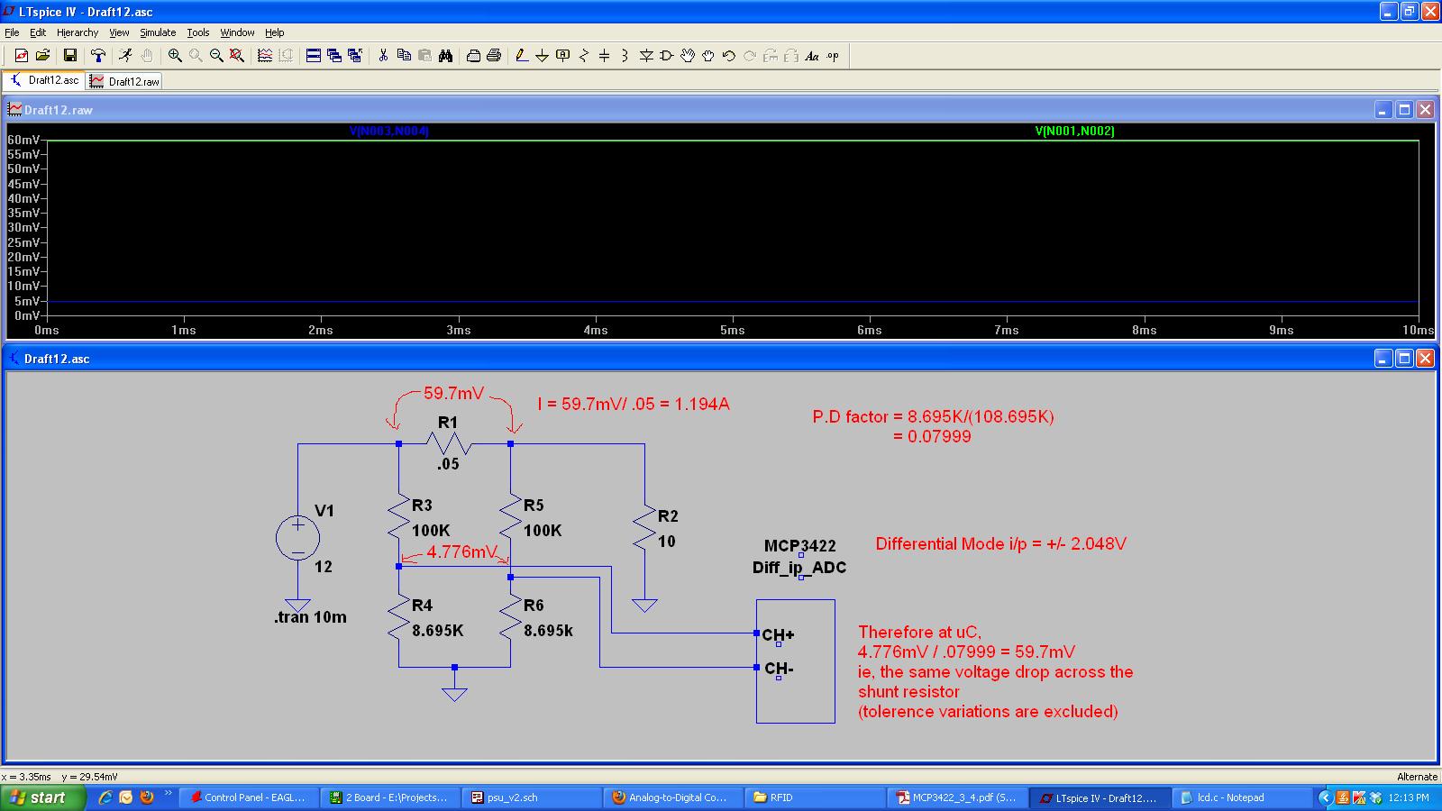

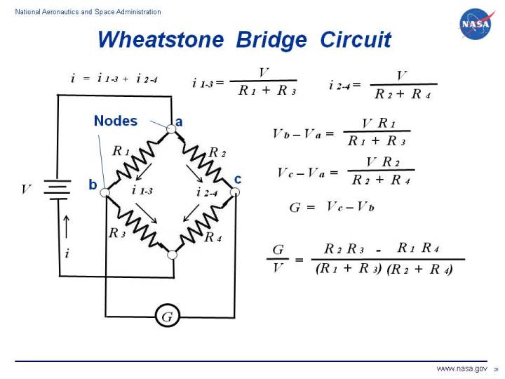

I need to implement a high side shut resistor based current sensing with a Differential ADC. Here the line consists of around 12VDC @ current varies from 1 to 10A. Eventhough the drop stands within the Differential i/p voltage limit(+/- 2.048V), its common mode voltage is higher than what is allowed.
Also I am aware that, there are some dedicated ICs and Opamp based instrumentation amplifiers are available, I am just trying to implement with same ADC & less components (as shown in the attached image.) . Simulation everything seems good, but before implementing I am seeking some advice from you. Whether this is a good practice for implementation. Hoping for your valuable suggestions.

With just a resistive 'bridge' the actual bridge output is low for a 10Amp current.
The 0.05R IMO is too high a value for a 10A sensor, at a load current of 10A you are 'losing' , 0.5V across the shunt.

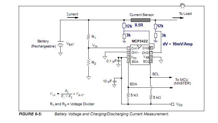

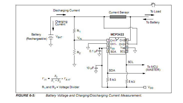

Looked at the MCP3422, why dont you use the example circuit shown in that data sheet.?

Yes, for 10A it will drop ~0.50V across it. Maybe we reduce the shunt resistor value for reduce the drop. In this case it can be adjusted.
In the application circuit, there are used it for the small battery sensing, whose common mode voltage is very less than its rated values. (Its mentioned in one of its App Notes.
The max. allowable voltage to its pins is
• Input voltage < VDD+0.3V
• Input voltage > VSS-0.3V
And ADC's sensing range is within the VREF (in this case a fixed internal VREF of 2.048V). So we can't give more than that. In the differential mode , the input voltage range should be within +/- 2.048V
–VREF ≤ (VIN • PGA) ≤ (VREF – 1LSB)
Where:
VIN = CHn+ - CHn-
VREF = 2.048V
& in this case ~ 500mV is applied which is safe.
But its common rail amplitude become to 12V which can turn on the input ESD protection diodes, and result in input leakage current, causing conversion errors, or permanently damage the device.
So in order to minimize this voltage , i put a voltage divider to the both differential legs. (now for this 12V, it comes around ~950mV accordingly. )
Regards,
Geo
I understand you must not exceed the Vdd rating.
I was thinking of resistors that would give a higher output to the MCP.
This is a rough sketch of what I would consider.
E.

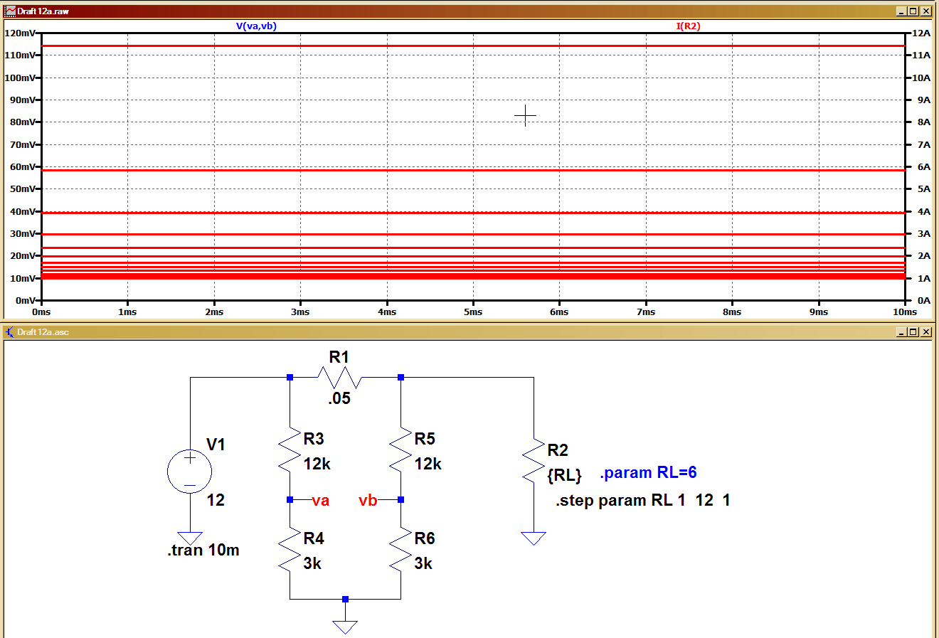

hi Geo,
I would say that self heating would not be a problem.
The 4 resistor circuit is a standard Bridge configuration. the 0.5R voltage change just 'unbalances' the bridge.
The problem with your high values is that they reduce the sensitivity of the bridge.

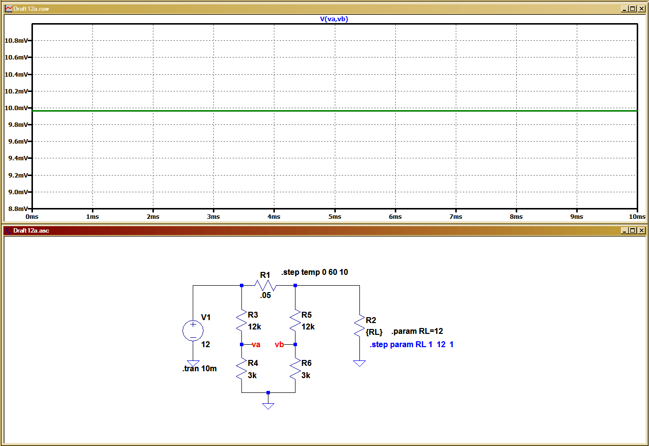

For explanation assume that the resistors were all the same value and they all had the same temperature to resistance coefficient.
Then if you heated them all at the same time over a range of temperatures, the differential output from the bridge would not change.:D
Have you tried a LTSpice simulation for the 0C to 60C range and measured the Vdiff change.??
E

That's interesting and I never thought of that !
Honestly , that temp directive was new to me. !! From the attached image its showing a constant value itself. That's great !.

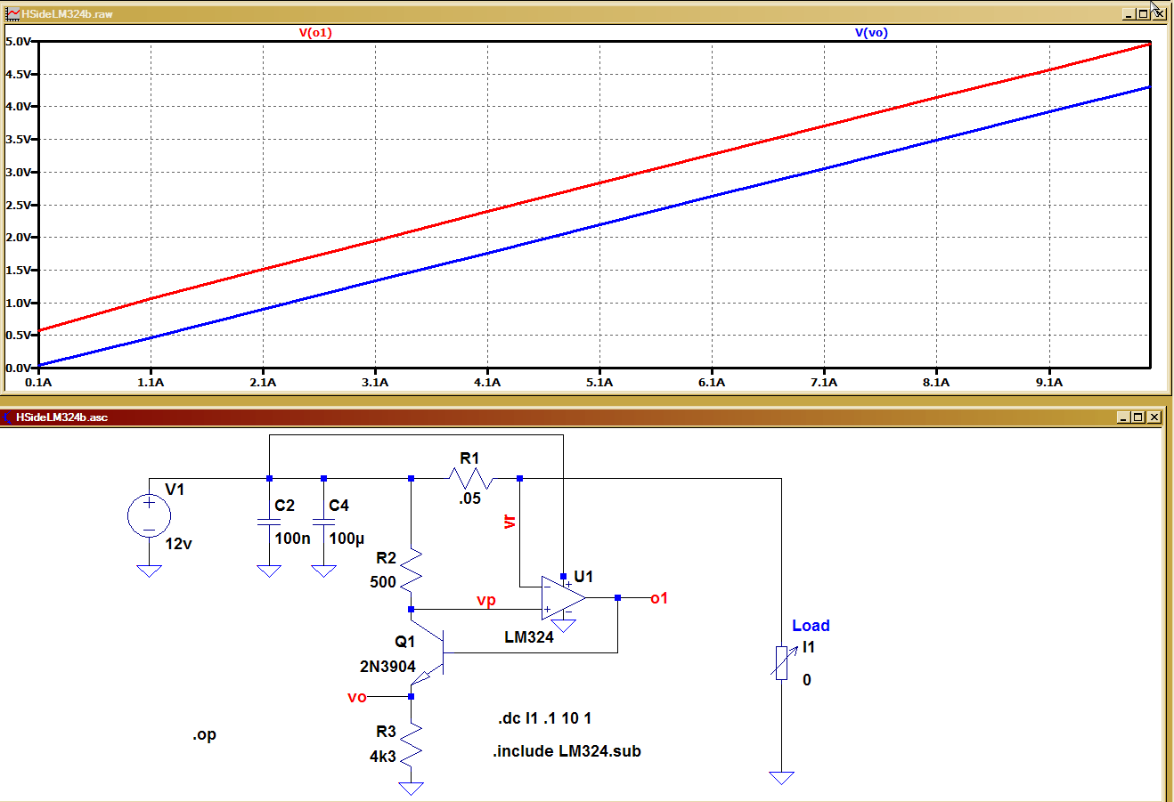

hi geo,
For reference only, this is a method I use.
Use can use a part of the LM324 OPA to offset the base 0.5V if required.
E.

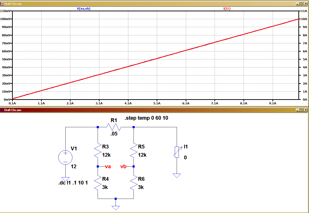

EDIT:
Second image is your bridge, sensing 0.1A thru 10A and the Vdiff output, over 0C to 60C

Yes, I should have typed 0.05R not 0.5R.:eek:
If you get say 100mV at 10Amps from the bridge and use the MCP3424 at maximum gain of 8, thats 800mV.
If you use a Vref of say +2.5V , then [0.8V/2.5] *65536 = 21000 decimal max [5208 hex]
This means at 10Amps its very roughly ~ 500uA/bit resolution, which I would say will be OK.
Do you follow that OK.?
E
