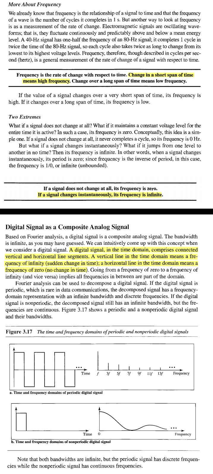

Q1: It is said that rising and falling edges, such as those of square wave, imply high frequency content. What does in really mean? For example, periodic square, sawtooth and triangular waves, all three have infinite number of harmonics of the fundamental frequency extending to infinity, so all three have high frequency content. Right? But a square wave has rising and falling edges which are more vertical than those of other two, so this should mean that a square has higher frequency content than the other two. But all three have harmonics extending to infinity. Please help me with this.
This is the reason I can think of. Although the harmonics extend to infinity but higher harmonics can be ignored without actually affecting the waveform because they have such a small amplitude. Let's take the case of a square and sawtooth waves. Perhaps, in case of a sawtooth wave all the harmonics above 1000 Hz can be ignored but ignoring the harmonics above 1000 Hz for a square wave will greatly affect the shape of the waveform.

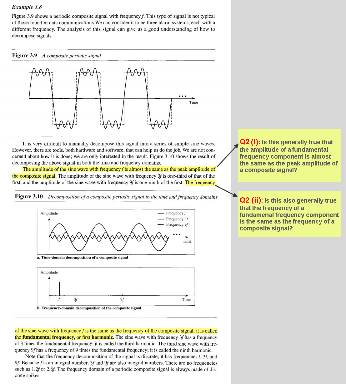

Q2: Please have a look here.

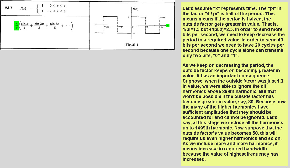

Q3: In analog communication a medium should be able to support at least that much bandwidth as is required by a signal. For instance, suppose that we want to send the an audio baseband signal (speech and music) by a wire instead of transmitting it using AM then this would require that the wire at least support 5 kHz bandwidth. So, for analog communication the rule is simply that the medium should be able to support the bandwidth required by a baseband signal.
In case of digital communication the bandwidth is given in terms of data rate (bits per second). For example, if data rate is 500 bps, it means that the medium can 'transport' five hundred bits from one place to another in one second. The Shannon formula gives us relationship between bandwidth (range of frequencies) supported by a medium and data rate supported by it. If you need more data rate (wants to 'transports' more number of bits in one second) then you need to have more bandwidth assuming signal to noise ratio remains constant. What's the underlying reason for this relationship?
If I had been asked to explain this, I would go like this. (Please first note that my whatever I'm going to say is based on my reasoning given in last paragraph of Q1. If my reasoning is not correct there then whatever I'm going to say isn't also correct.)
For the sake of starting this discussion assume that a periodic square wave is used to send the bits (periodicity means that bits are sent like this 010101010101010101). When amplitude of the square wave is "1" it means bit "1" and when amplitude is "-1" it stands for bit "0". Now please have a look here. Do you agree with me?
In almost all practical situations the sequence of bits in non-periodic and it is represented by non-periodic square wave. It is my experience that non-periodic signals almost always require a large bandwidth. In other words, they always have significant higher harmonics. The more non-periodicity or randomness there is, the more bandwidth is required. We kind of say that the amount of non-periodicity or randomness is proportional to the required bandwidth. Do you think what I say is generally true?
You might find links #3 and #4 helpful for this question.

Too many questions for one post i think, but that's really up to you.
For Q1 i think you have it right. Looking at it mathematically (as we should almost always do anyway) we find that the square wave has harmonics that are 1/n where n is the harmonics number 1,3,5,7,9, etc., all the odd guys. The triangle wave however has harmonics that are 1/n^2.
So except for the first harmonic, the triangle wave always has harmonics that are less than the corresponding harmonics in the square wave. So no matter how many we look at we will see less content in the triangle wave.
Lets take a quick look at a particular harmonic, number n=9...
The square wave amplitude is 1/9, while the triangle amplitude is 1/81. That's quite a bit different even though we are only at harmonic number 9. The triangle wave content is much lower.
In decimals the square wave content is 0.11111111 while the triangle is 0.012345679, so that's a pretty big difference.
So if we used a sharp low pass filter we would see a bigger difference in the square wave than the triangle wave. This means if we have a bandwidth limited media we should see less effect for the triangle.
Put another way that is also practical, if we have a square wave that is nearly perfect with very fast rise and fall times, if we want to limit the frequency content we would try to get those rise and fall times to 'slant' up or down, on an angle, so that they take on the appearance more of a triangle ramp than a square wave sharp rise or fall. That helps reduce radiated EMI which helps get past certain required government compliance tests.
Q1: Fast edges and sharp corners both imply high frequency content. That's why both square an triangle waves have high frequency content. Infinitely fast edges or perfectly abrupt slope changes imply infinite harmonics.
Q2a: It is generally true, but I would guess that you can find some interesting exceptions to the general rule.
Q2b: Is more than generally true. It is always true.
Q3: This question has so much in it that it almost becomes a loaded question. It's hard to answer without saying something that is not quite right. I'll give more thought on the right way to answer, and I probably have to look up some things I forgot. Damned, if I could just remember all the things I've learned, I'd be a pretty smart guy. :)

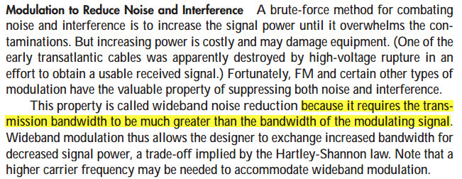

steveB said:
Q4: Noise and bandwidth are generally related because the noise is spread across the frequency spectrum. Hence, typically noise can be reduced by deliberately filtering out frequencies that are not needed because they are outside of the band required by the signal you care about. A good example is Gaussian white noise. It is equally spread across the frequency spectrum. Hence, you pay a high penalty if you open up the bandwidth beyond what the signal needs.
Okay. It makes sense. But don't you think this text is suggesting that the more bandwidth you use, the more reduction there is in noise? I thought I should clear this seemingly contradictory statement. Thanks.

Q1: I wouldn't say those ideas are contradictory, but I would say that the advanced wideband modulation schemes based on Shannon's Information Theory is somewhat counter-intuitive at first. I remember studying spread-spectrum techniques using coding 25 years ago in a communications class. When you study the details, it actually makes perfect sense. But again, the details have faded from my mind. I can't say all wideband technique are as intuitive because I haven't studied them.
Q2: Generally, you don't want to do this. The resulting spectrum can in principle still have the baseband information in it, but I'm not sure how you would demodulate it. Still, I can't say for sure that nobody hasn't played around with this idea. People try all kinds of crazy things.
