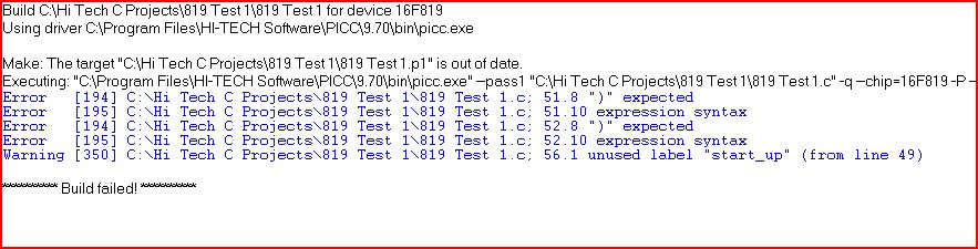

Why do I compile a bit of code, get loads of errors, build the same code immediately afterwards, and it builds with no errors?
I can then load that code into a PIC (16F819) and it works OK.
New to Hi-Tech C, or any other C for that matter.

The code does nothing I know. Deleted most of it, still leaving error.
So, build was OK. Put in the last comment. Build gave error shown. build again, OK.
First time I've used tags. hope it works...
EDIT Start_up line 49, IF on lines 51, 52,

Your #define statements are wrong. #define run_sw RA1; defines run_sw as RA1; (*with* the semicolon) whereas presumably you want it defined just as RA1. #define statements are not terminated with a semicolon but with an end of line (hence the need to put a \ at the end of each line of a multi-line #define).
So
if	(run_sw  ==	0) 	goto	start_up;
will be translated as
if	(RA1;  ==	0) 	goto	start_up;
which is incorrect syntax and the errors are pretty much what I'd expect to see from any compiler. This doesn't explain why the compiler appears to compile the program successfully a second time though. A compiler bug perhaps? But it's anyone's guess what code it's producing.

Did actually get it sorted, but did not put a \ at end of each line.
Put:
#define run_sw PORTA, 1
#define dir_sw PORTA, 2
That seemed to work OK. But still got errors. So, copied the original, non-truncated, code to Wordpad, created a new project, pasted the text in, and no more errors. At least, not those.
It appears the project got corrupted in some way.
Now been stuffed into a 16F819, and it seems to do what I require.

The bit about the backslash applies only to multiline defines (that's defines that take several lines). They do not apply in this case, that was just an aside.
R-ing TFM shows PORTA,1 is special compiler syntax for bit 1 of PORTA
HI-TECH C Compiler for PIC10/12/16 MCUs v9.80 User Guide
This is non-standard C, so "if (PORTA,1==1)" in standard C will always evaluate TRUE due to the comma operator and 1==1 being always TRUE.
I've seen this with Hi-Tech PIC18 compiler many times. The reason it "works OK" is because I believe it is used previously compiled code (object code) from when you had something that would compile earlier. Because of this problem with the compiler, you should always use the rebuild all button.
