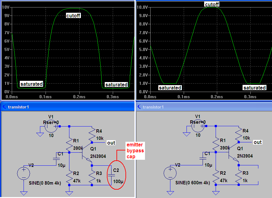

For low distortion in a transistor common emitter transitor circuit, keep the output voltage well away from the supply voltage and use plenty of negative feedback by using an unbypassed emitter resistor or other ways. I attach a sim of a transitor producing about 40 percent distortion!
With the emitter resistor unbypassed, the distortion is only (!) 3%. The distortion is lower at lower levels.

Hi Digitan,
Look at my sim example.
With the emitter resistor bypassed on the left, the gain is 18 times or more than the other, but it has 40% distortion at high levels.
The one on the right side is the same except I changed a bias resistor so it is better centered and it doesn't have a bypass capacitor across its emitter resistor. The emitter resistor then provides negative feedback which reduces the gain 18 times or more and reduces the distortion down to 3%. :lol:

No. It isn't saturated and it isn't cutoff. It is just very badly distorted because transistor circuits as simple as this are lousy.
And when the resistor can't be bypassed, the gain stays low. Is this part correct?
Correct. But I increased the input level about 18 times so that both have the same output level.
Here are both circuits with the input levels increased so that the transistor is saturated and is cutoff:
mstechca said:
The gain is slightly lowered, and it depends on resistance.
No. Bypassing the emitter resistor increases the gain 18 times or more. Since the resistor is bypassed with a 100uF capacitor that is like a dead short to the signal at the emitter, then the transistor doesn't have any negative feedback. Negative feedback reduces gain and distortion and increases bandwidth.
Distortion and gain tend to inverse each other.
No they aren't, look at my pics. The one with high gain also has very high distortion. Negative feedback reduces gain and distortion.
