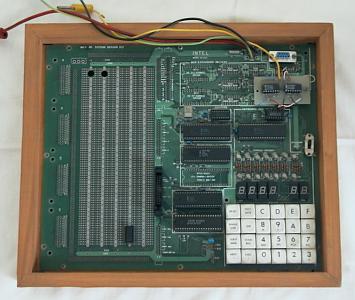

As you know, this is the machine we use Intel SDK 85

Wow, that must be the original Intel SDK 8085 board. Does it have any serial RS232 interface so you can write programs on the PC and download the hex to the RAM in SDK. If not, it would be tough to write a program by keying in the Hex on the keyboard.

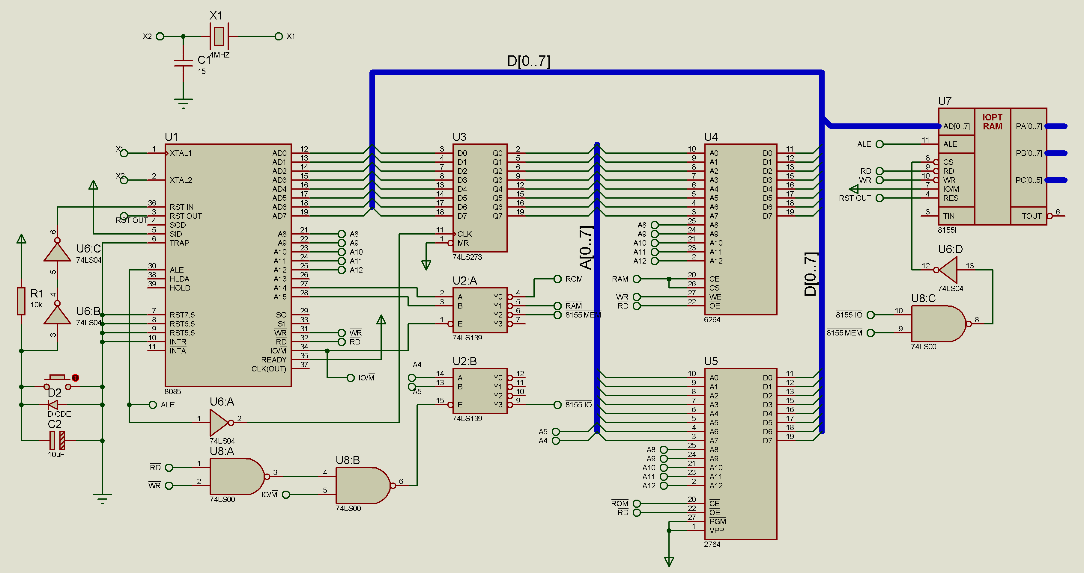

There is a better 8085 development board here....

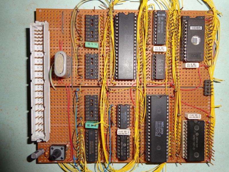

The attached picture is my 8085 SBC on stripboard using wiring wrapping.

lo,, the one you put it look like the new one and I guess we use very old one.
We write program by using Appendix F which gives the 8085 Instruction Set (Table 5) of the book call Microcomputer Theory and Application with the Intel SDK-85
