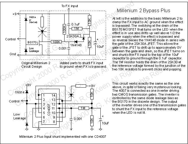

:!: i need an equivalent for bs170 mosfet or similar mosfets for my millenium2 bypass, its hard to find here in the Philippines.. also a lowleakage diode.. thanks 8)

Kabayan, I did a google search of your "Millenium 2 bypass". There is a alternate circuit using more commonly available parts like the CD4007. I don't fully understand the function of the 1n914 and the low leakage diode. The circuit could work with only a 1M resistor replacing the 1n914. Anyway there are already protective diodes a the input of the CD4007.
http://www.geofex.com/Article_Folders/Mill2extn/mil2plus.htm
