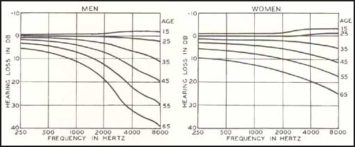

I have normal for my age (73) high frequency hearing loss. The loss is shown on a graph on the web and a free hearing test showed it. I was given free demo hearing aids for one month and I loved them so me and my government senior's grant bought them. My hearing aids are programmed to boost the high frequencies perfectly to match that loss which is more than 100 times at the highest frequency. Low frequencies are boosted only a little.
The Velleman kit boosts all frequencies only 50 times which would overload my hearing with low frequencies and not boost the high frequencies enough.

You should take your grandfather for a free hearing test and free demo hearing aids. My demo had the high frequencies boosted only a little at first so that they didn't overwhelm me, then more boost was added each week. Look into what your government pays for that helps seniors.
Here is the graph of "normal for age" hearing loss:
